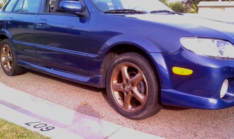

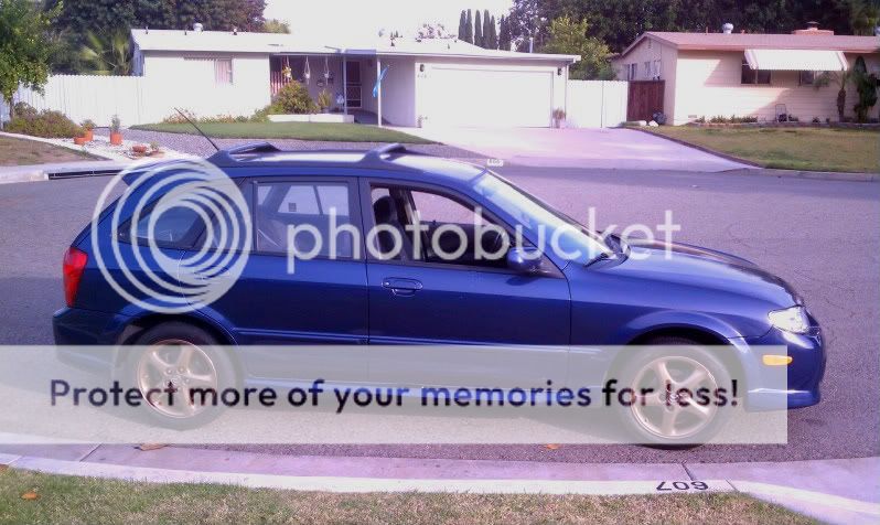

OK so i bought my P5 about 2 months ago and I noticed this issue. I'm just getting around to figuring out what's wrong. at first look it seems like my drivers side is really low. the distance between the tire and fender on the drivers side is about 1" and almost 3.5' on the passenger side. so the struts are bad right? thats what I thought but I get the strut clunk from the passenger side. also when you look at the struts and compare them the drivers side looks brand new and the passenger side looks old. So my question is can strut failure some how cause them to lift the car instead of sag? or what else could it be?
Sorry for the Crappy pics all i have is my Phone.
The Lean..
Passenger side

Struts don't support the car, springs do. It's probably got a broken spring. From the one side angle it looks like the alignment is out of whack, looks like a bunch of positive camber. Something is definitely messed up in the frontend. It looks like it took a hit in the frontend too, and the side. I think it's got some pretty serious damage going on. Pop the hood and take some engine bay pics.

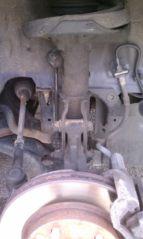

Need to make sure the spring is in the perch correctly. This is definitely not a strut issue. Struts dampen, springs hold the height.

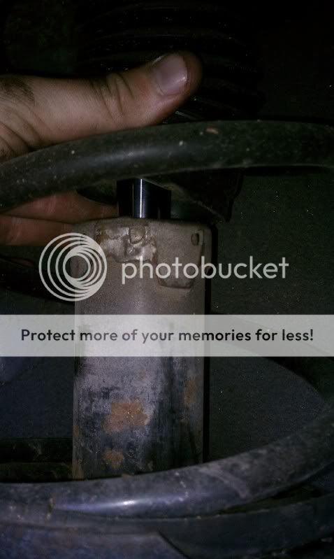

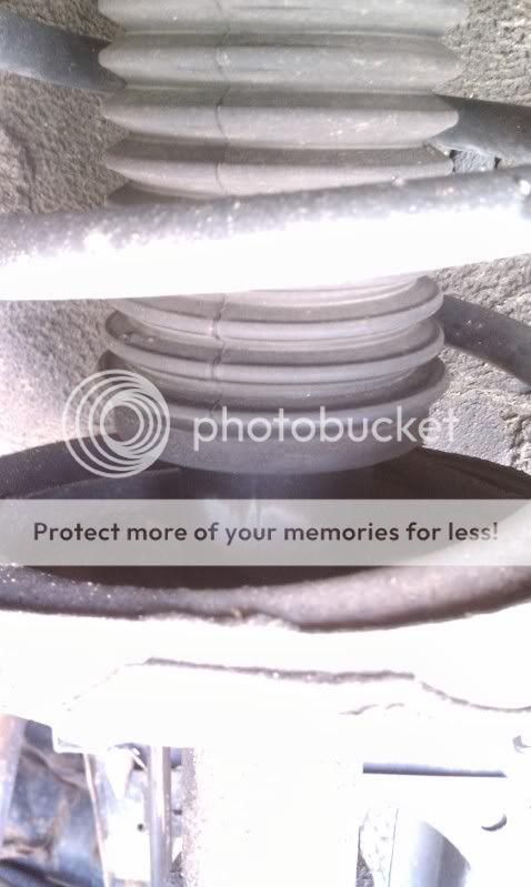

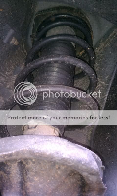

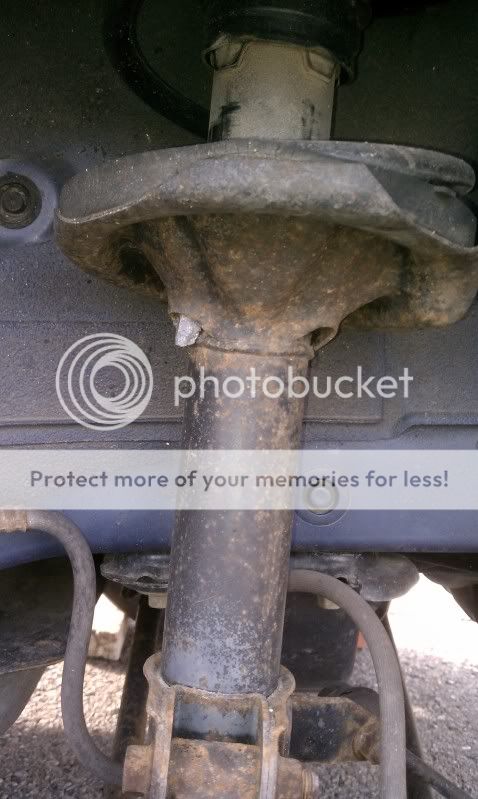

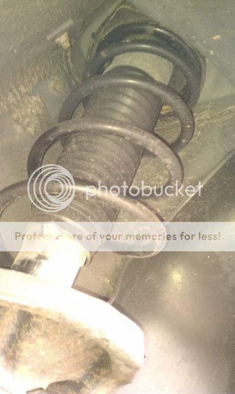

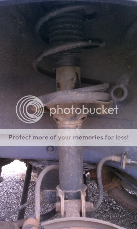

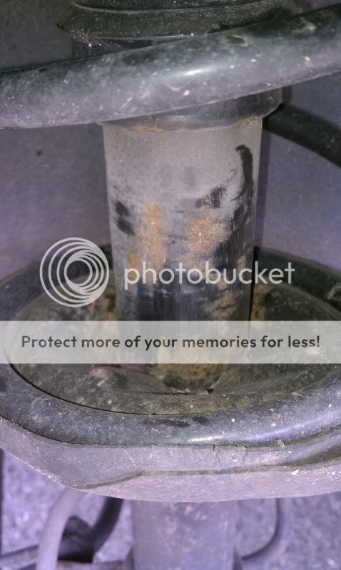

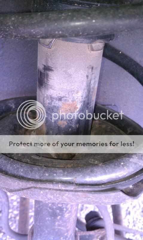

ok i finally got the wheels off to snap some pics. So here we go...

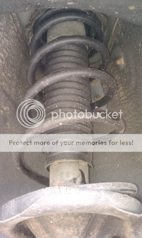

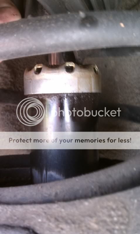

Here is the Passenger side front.
Looks like the strut is leaking a little bit.

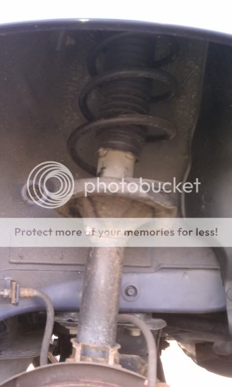

Passenger side rear

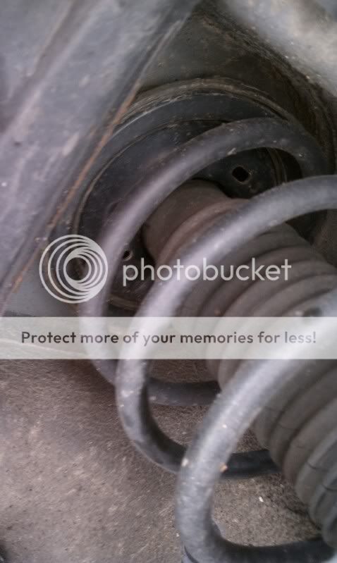

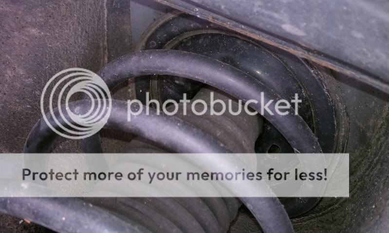

Here are the pics of the drivers side rear..
I couldn't get the lugs off of the front so I'll have to wait on those. Any ideas?
not quite sure what to look for when it comes to if the spring is on correctly. so let me know what you see.
