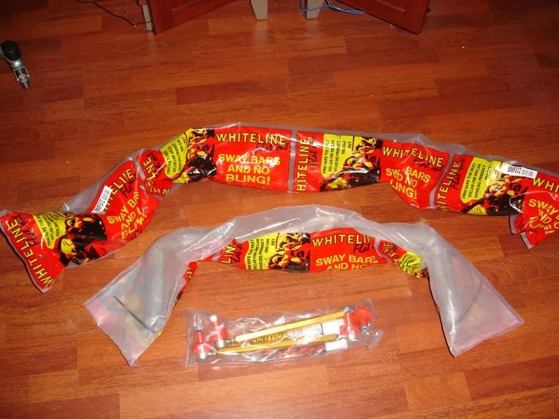

So this showed up today at my house.... what could it be?
Looks like a few packages from Whiteline.... who's that?
I Like!
Well thats starting to look like some kinds up suspension piece

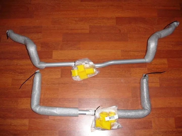

Certainly looks like suspension parts now

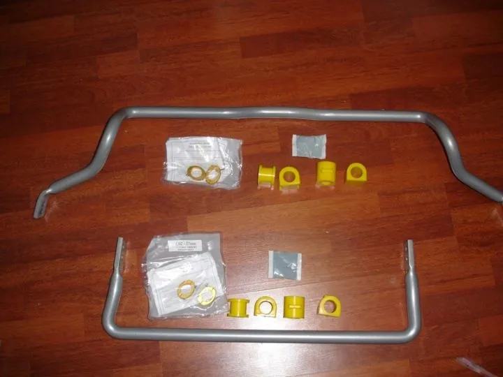

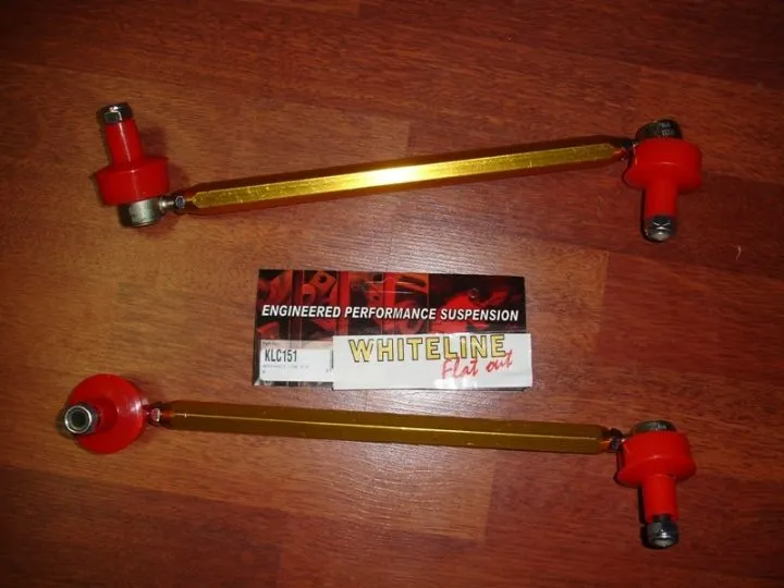

WhiteLine Suspension Upgrades.... F&R Sway Bara w/ F End Links

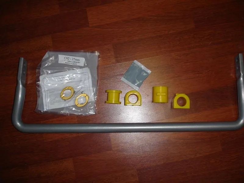

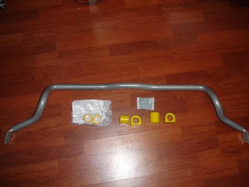

Ok now we area talking Whiteline Rear Sway Bar w/ bushings, lateral locks and grease.
Front Sway bar w/ bushings, lateral locks and grease.
WhiteLine...... GOOD STUFF

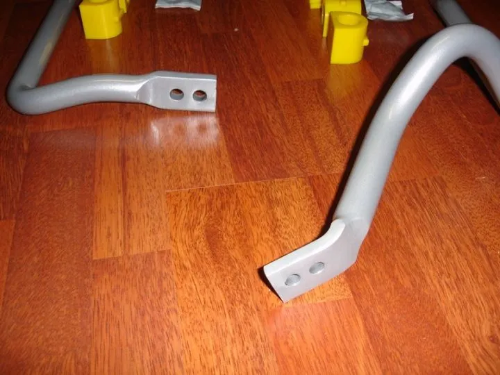

27mm thick Sway bars w/ Adjustable points of atachment

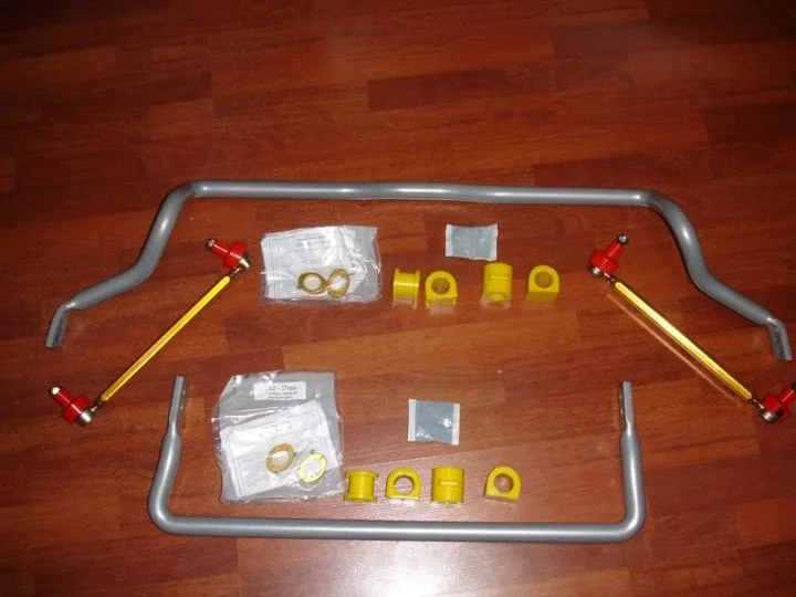

F&R Sway Bars and Front End Links ready to be installed.

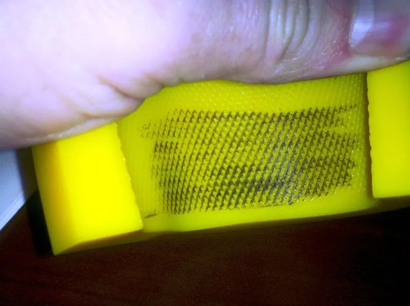

Side note that i feel is important, the Whiteline bushings have a honeycomb looking pattern stamped on the inside of the bushing all the way around, which gives a tiny little impression in the bushing were the grease can go and stay in between the bushing and sway bar without getting squished out. )oem bushings have a smooth finish) Picture below... i put a little marker on it so it would show up better, i think this is a great enhancement. Good Stuff!
