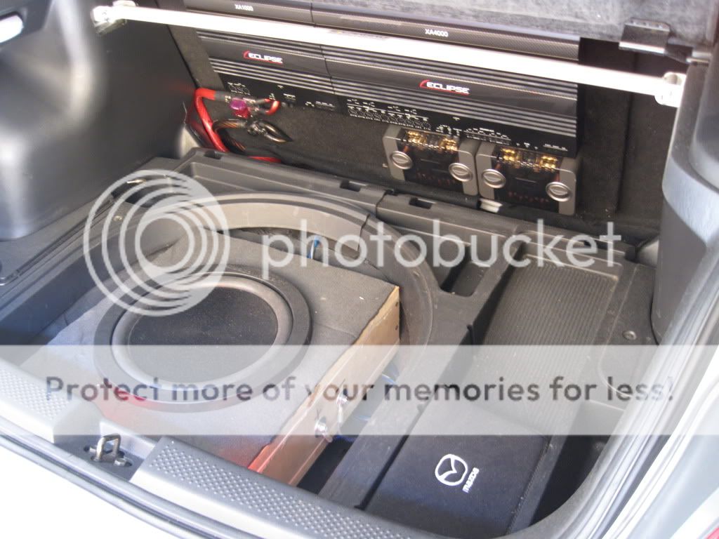

I'll update with my spare tire well box. Since the Stereo Integrity BM mkIII I used is only 3.5" deep, I was able to just build an MDF box that sat on the spare tire hump. The box is 0.5 ft^3, so you could definitely get a nice sized fiberglass box in the spare tire well.
I understand i am bumping this thread from a while ago but that sub box looks very nice. I'm semi-surprised I haven't seen anyone fiberglass a sub into the spare tire well. You could probably fit a really nice 12" in there that pounds like crazy without losing space.
Thanks, the biggest challenge is keeping the box in there. It is top heavy and pops out once in a while. I have had decent success with Velcro.

Fiberglass can be just as strong as MDF, especially in round sections. You can also build it up to over 3/4" thick with no worries of it flexing.
