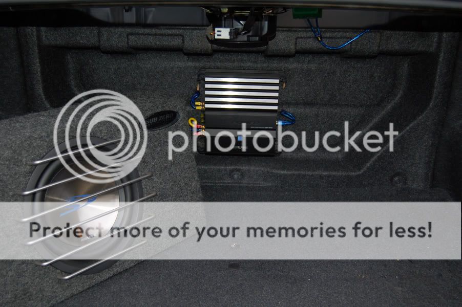

I've got a pair of JL 10W3v3's (sealed box) powered by a 500 watt TMA amp in the trunk of my MS6. I have to drive around with them turned down (-3 or -4 on the bass setting). They sound amazing even with the seats in the upright position. - As far as which way the subs should be pointing, i have mine pointed away from the passenger compartment, it seems to give the best quality of sound.
I just installed mine this weekend, and after some "tweaking" and working the bugs out, it sounds alot better. It sounded really weak, and I realized it was because the writeup I used only connected the positive RCA leads to the vehicle wires. I went back this morning and connected the negative parts of the RCA wires to the brown (in my 06 MS6) wire, and it's a world of difference. FWIW, my sub is facing the rear seats, and ported towards the rear of the car. It's just temporary right now until I decide which orientation I like, and decide if I want a different box to keep it clean and out of the way.
