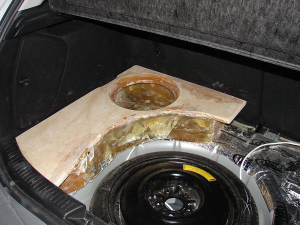

This was using an amp I later removed. But the idea is the same:
This was my orginal idea, a 12" slimline sub. I got very close to completion when I ended up winning an LMT sub on ebay. And then, I scrapped the box design to make the new LMT work.
I'm really liking the design of the pics that Cashmere posted. It looks like the jack and stuff still fit in there? Now time to practice with some fiberglassing....
ffourth, pics look great.
what material did you use to cover the box ? looks soft almost
synthetic suede, found at jo anns. I also put Ensolite (Raamaudio's soft closed-cell foam) under the faux suede, to add a slight padding to it. What you see here is actually scrapped, and I'm working on something else. Still, the suede stuff is sweet.
