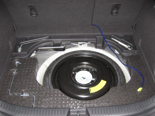

thats one big box haha
haha, yeah. thankfully it's removeable but being tall i have to do some funky leaning to get it out.
i used winisd pro to design it. it's amazing how different the manufacturer's suggested box specs are vs. the actual proper box design!
