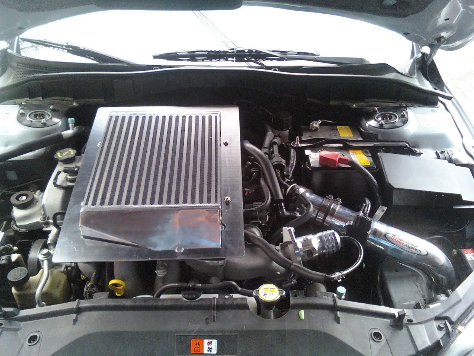

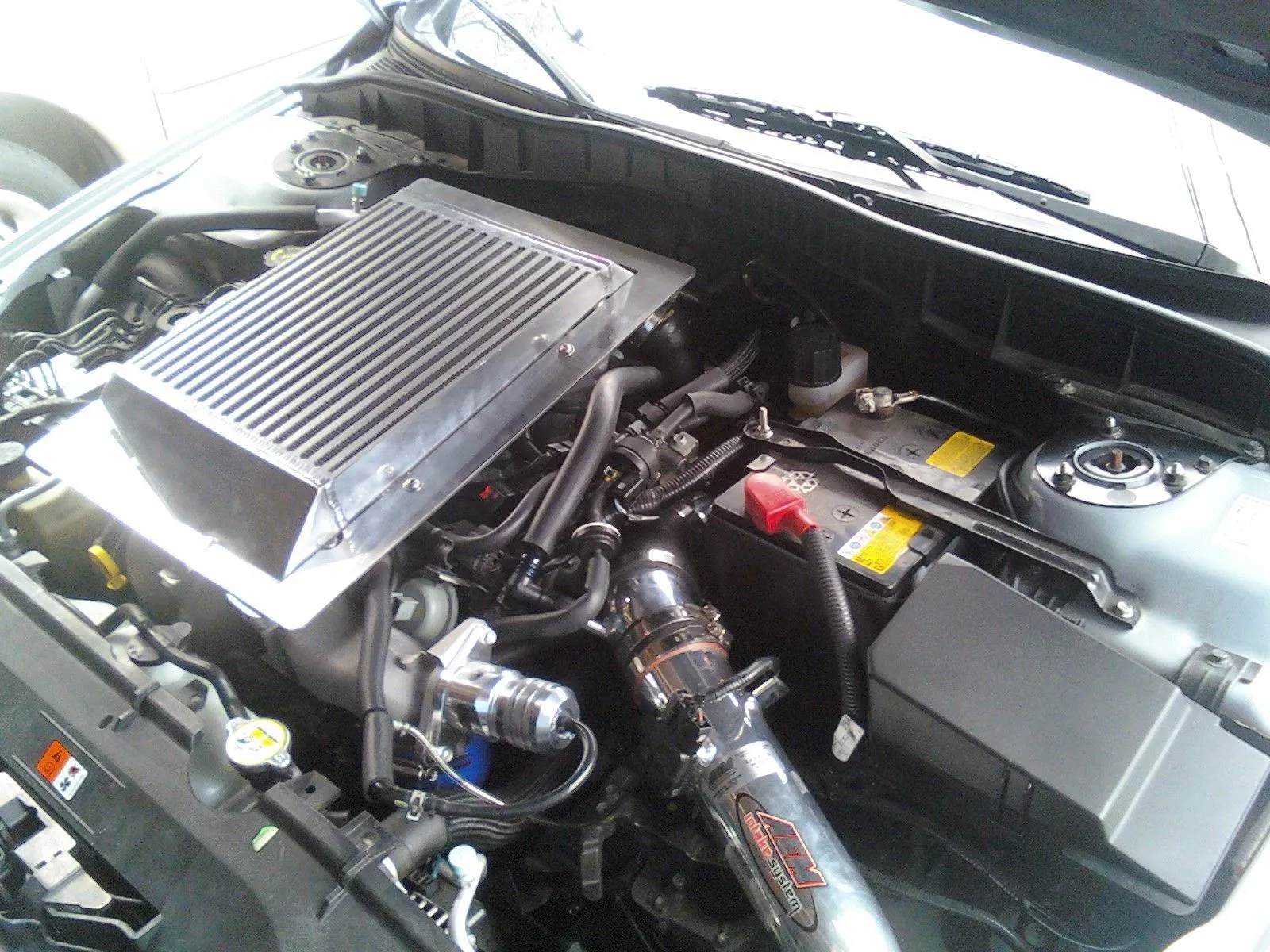

ok i have to say that i just installed my su tmic and love it. you basically get a lot more mid range power..the car keeps pulling hard in every gear and doesn't seem to drop off. now on with the rear boost tube...it sucks ass..you guys all had some kind of slight kink...in my car i had a complete fold...so bad i don't see how air could of gotten through..and im pissed ...and will be complaining to su today
here is a pic
