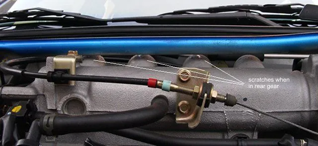

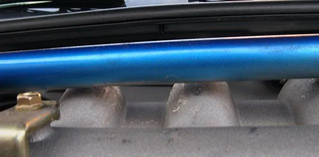

hi there.. today i got my car lowered with eibach prokit and the oem p5 strut bar that i got from canada was also installed...
the problem was that the ZM engine is sitting "too high", so the strut touches it when it's installed...this is not good when the engine moves(loser)
so the mechs put a wooden wedge between the strut and the gasket,took some steel bar and levered/bent the the strut a little more upwards with HUGE POWER... the whole engine went up and down while they did this and finally they got 1/2cm between bar and engine... damn, i almost pissed my pants when they did this... but now it seems to work..
just to let you know (i know there is at least one other p5@ZM guy here :)
i will take fotos later..

I have an idea. Tell me how far up you need the bar raised and how far before it hits the hood. I think I can make a threaded extension to raise the bar a little. Might just have to drill the mounting holes out a little.
if i could raise it on the left side for 1cm/10mm/0.39inch this would be enough i guess and it wouldn hit the hood (because right side is higher anyway) of course it would also help lifting it at the right side too, so the left side would also go up a little...
how can i in detail find out how much space is between the bar at that position and the hood (i mean it's the p5 oem... maybe you know :\ ?)

Stick some putty to the bar and keep making the putty higher until it touches the hood...then you'll know how much it misses the hood by.
putty like in the pic ? ahm uh..i will try that somehow, i will see how i can get this done.. any help is deeply appreciated, my mood is really ****** up because of this :\\\

today i drove to my mazamechs and we tried it with washers (4mm left, 4mm right).. not nealry enough..still touchin the manifold when in rear gear...
after that i found some company that is able to bend the metal exactly to my needs and but would cost 40, that's almost as much as i paid for the bar itself ...damn...
at least now i know that i would need a gap of 15mm (washers not to be used) at the place where it touches the manifold to be on the safe side... xelderx, what would your extension look like ?
