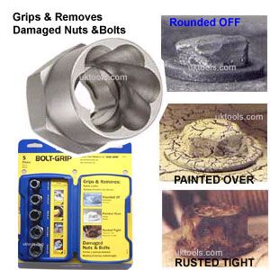

There's also this stuff,...
The vise-grips grab on three sides so it's always tight.
Just an update, the Irwin Bolt-Grip was the ticket, slipped it over the nut, cranked down on it and it loosened right up. The only problem was getting the Bolt-grip off of the nut, I had to grease it and tap it with a hammer for a bit while pulling with two Vise grips.

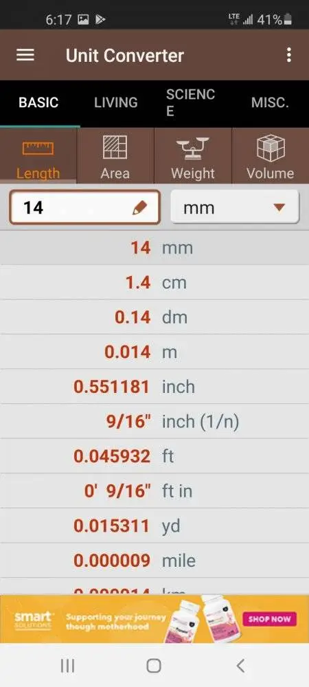

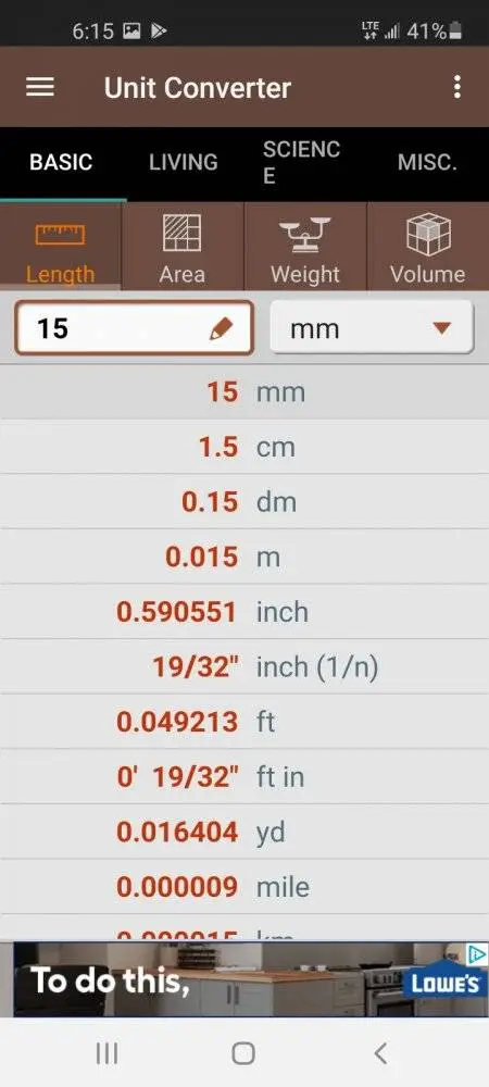

An SAE nut is very close to the metric equivalent.
If the nut is too big, chances are that the thread is not metric, but not necessarily.
Just make sure that the nut threads on all the way easily.
