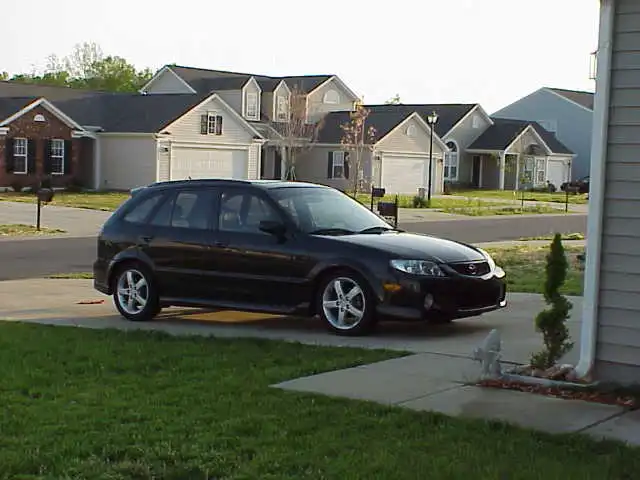

and for all those eager to see what it looks like after the drop here you go. BTW check out the tinted side markers and taillights. Will have more pics of those in another thread. Look for them.
spray tint from a local store is it? I have trouble finding that stuff where I am
actually I ordered it from summit. took 2 days to get but it was like $12 . Came out good though . I Actually need to get another can. will have more pics soon
