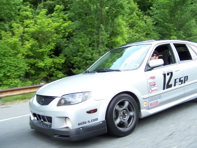

Car is down right now so I thought I would post a good pic to make me feel better. Thanks to Frank (01bluemp3)for the great shot.
Nice lip! I just got mine on recently and I'm digging it. You need to paint it though :D

My understanding of the rules (I could be wrong) says that if it is mentioned in the owner's manual than it is legal. Kind of like the crash bolt rule. I believe it is said in the owner's manual that the bottom cushion of the rear seats can be removed to allow for more cargo space. The seat backs have to stay though. I'm leaving the front lip unpainted. It would be a waste of money to paint something that will encounter a lot of stationary objects at high speed.

Alright, thanks for the rules information. You have a good point about not painting it :D I'll let it slide since it looks fine on your car... heck it'd actually look kind of sweet on a white one. Anyways, I took out some cones today but I haven't inspected the lip. Most of them were backend kills though.

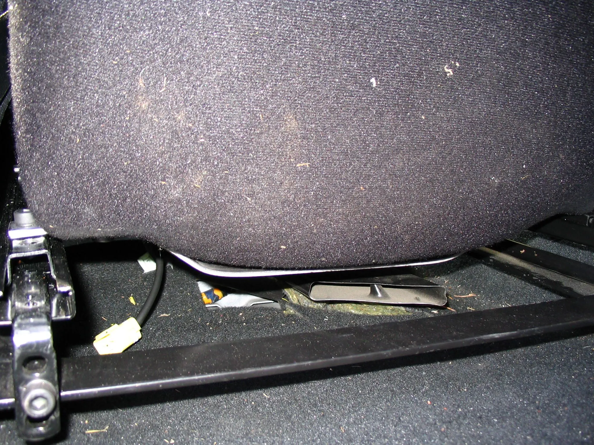

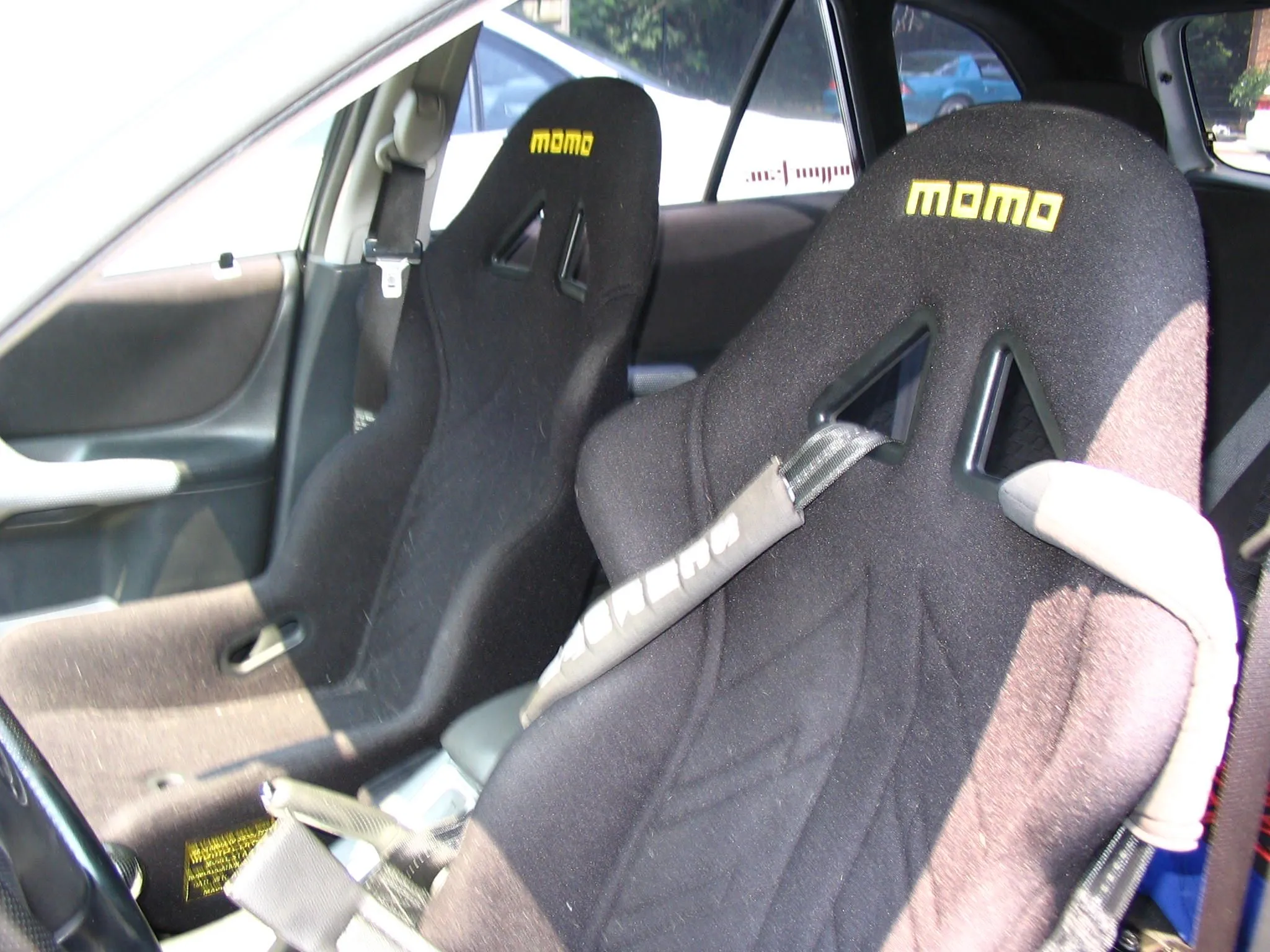

Finally got both seats mounted. I need to fiddle with a few things to get them the way I want, but at least they are in there. I'm going to pull the brackets back out and drill some holes in them to lighten them up. They are pretty heavy.

Where did you buy the brackets? When you pull them out, can you weigh them?
