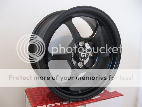

just picked up a set of motegi 2.0 traklite 15x7 +35 @ 10lbs looking at dunlop direzza's @18lbs ..much lighter than stock aluminum wheels/tire combo
Got pics of this combo?
heres a pic of the wheel and ill find a file photo of a dunlops
