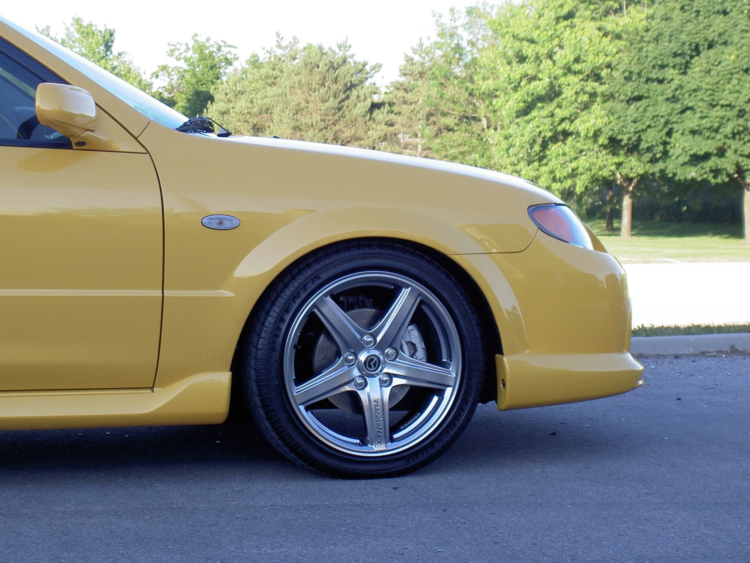

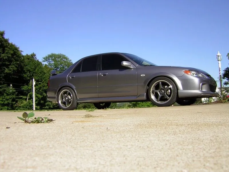

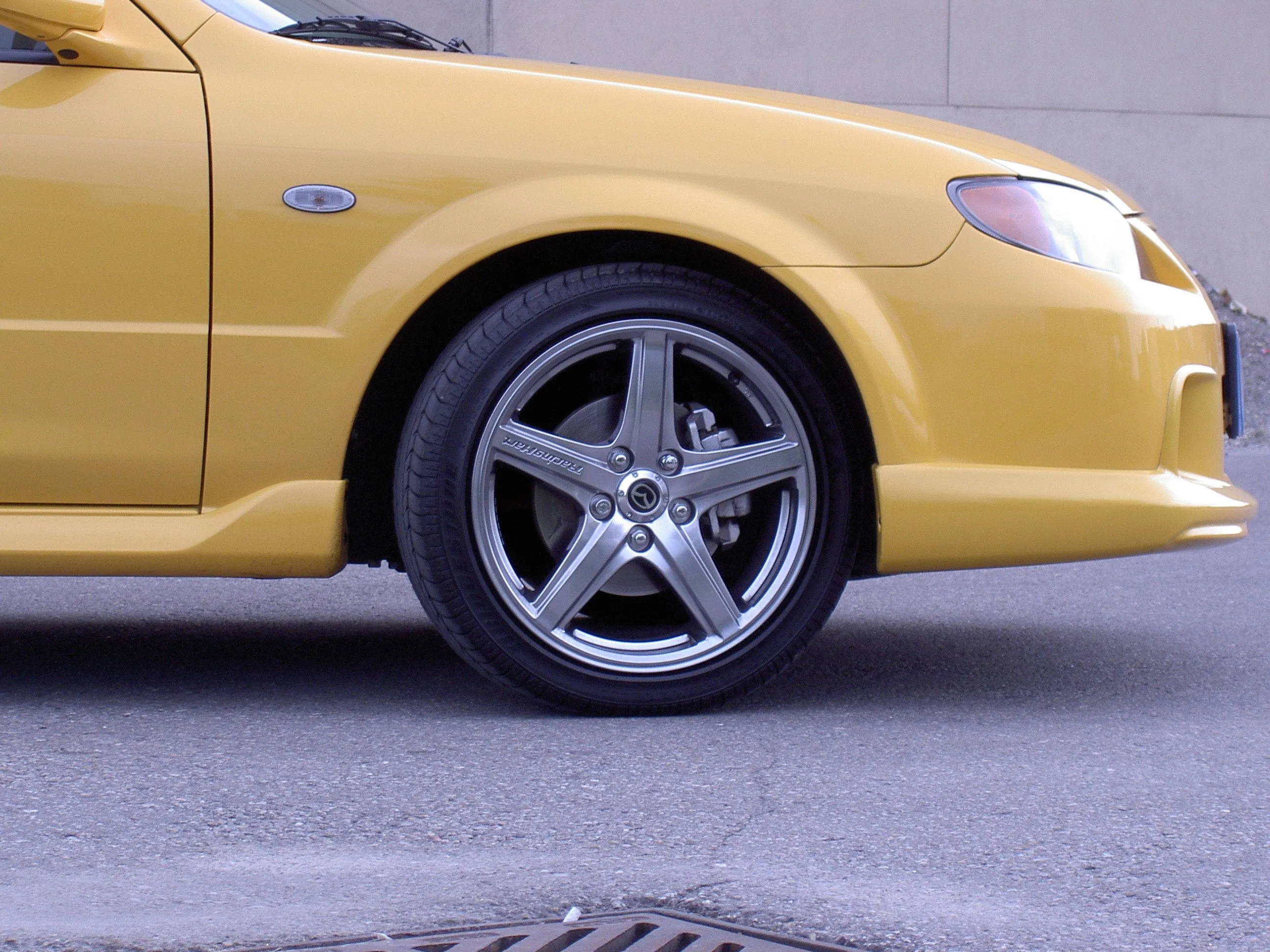

Anyone have a pic of a MSP with stock suspension beside a MSP with the Tein's on them? I'm really interested in getting these springs but just want to see a comparison pic. Any pics of just one MSP with a set on them are wlecome to. Everyone says to buy them from **********.com for $175 but apexr1.com has them for $165, is this website ok to order from, anyone had any problems with them?
Here you go...the rear drop is virtually not existant...maybe 1cm difference tops.
Apexr1.com are great guys to deal with...I got my Injen from them, no hassles!
First one is stock, second is Tein S-tech.

I just put on my Teins, tucks the front very nice and the rear lowers just a bit. I still think it looks great. When I rarely have passengers in the back, the rears will rub on hard turns or hard bumps....dependging on where the person is sitting. It is nothing major. I got mine for $155 shipped from Kuruma Motoring.
See attached photos (both after drop...sorry no before-drop pictures).
Be ready for a stiffer ride.
