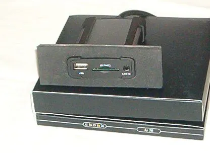

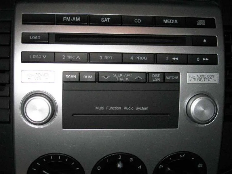

Anyway here is what I started with and the device I received. My Mazda5 IS A 2007 Sport (pretty basic).

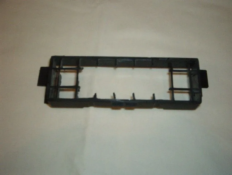

After I removed the face plate I decided I wanted my device in the unit where the cassette would go. I cut a piece of 1/4inch plexiglas to fit in to the face plate 11.8cm X 3.9cm then I sanded the original face plate down so that it would support the new face plate I was going to install.

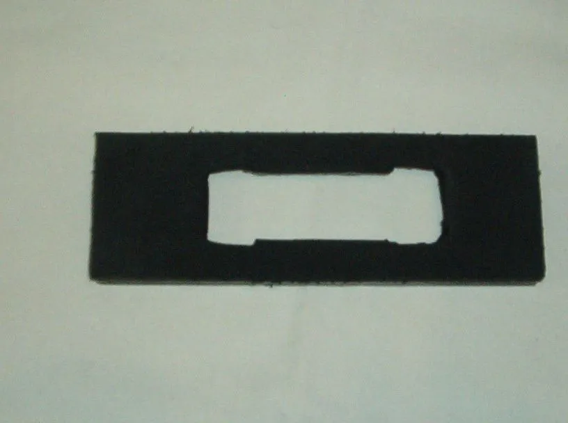

After getting the face plate sized and the opening in the face plate for the device to slide through I put a piece of 3/16in firm foam type cusion with one sided sticky adhesive. You put this on over the face plate and cut it insde of the face plate so that it will be a tight fit when the device is slid through it. In that way it will conform to the units profile and look neater as an installation goes.
