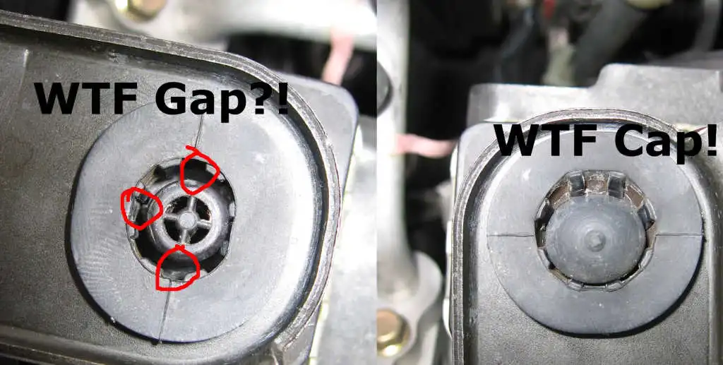

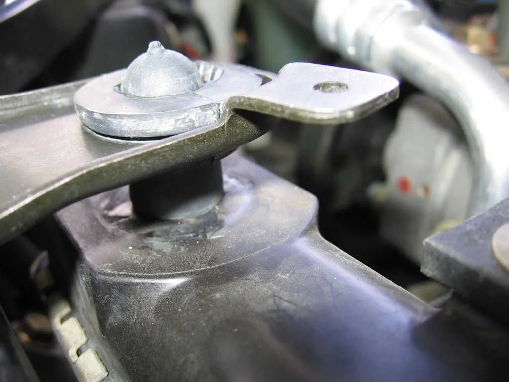

I came up with a pretty sweet solution. Put a big vacuum cap on the plastic post. The bracket really doesn't wanna slide down on top of the cap, but that's alright, now it is snug as hell.

OK resurrecting this old thread. Shortly after installing the cap, the piece of s*** stock bushing disintegrated. It was cut in two by the metal bracket surrounding it.
So I then had it set up for a while with the bushing gone, vacuum cap still there, and pulled snug to one side of the metal bracket via a very tight zip tie.
This worked ok for a while, but the vacuum cap slid off after a while.
