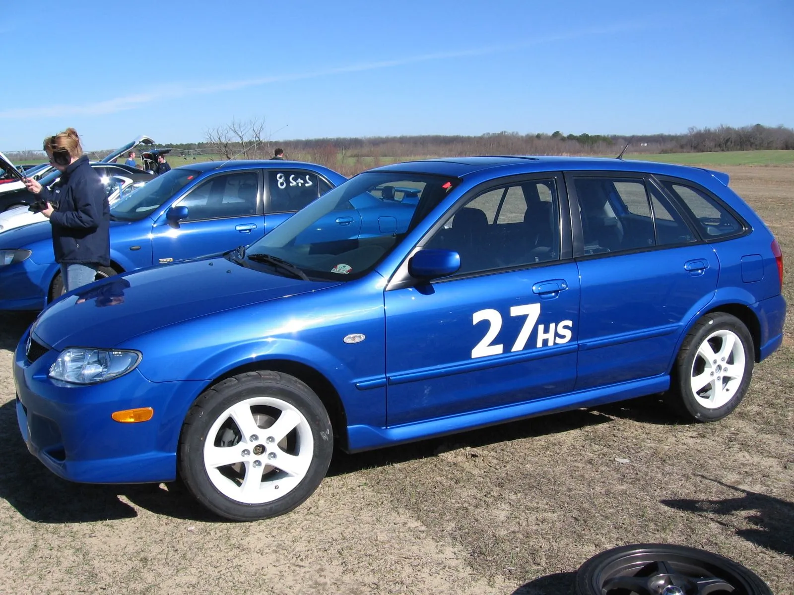

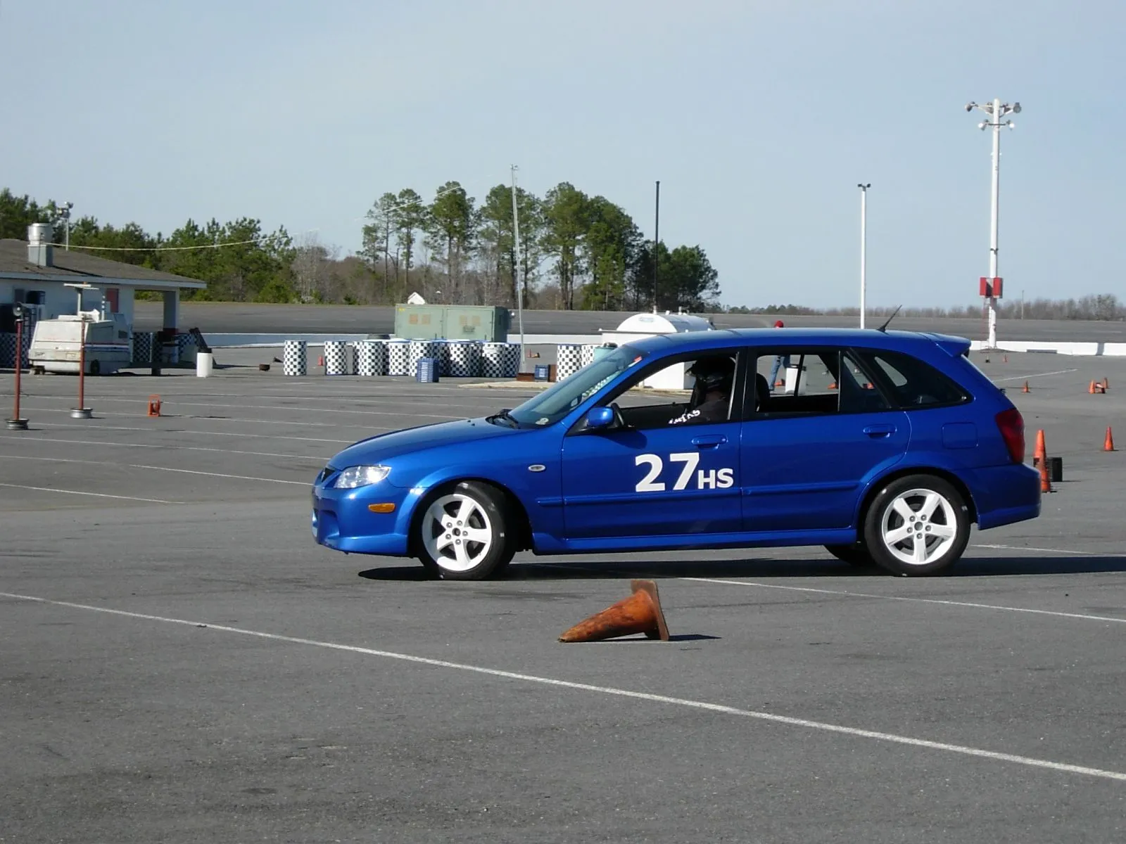

I painted my auto-x rims (read: stockers) white. Lemme know if u have any questions.

get the tape down between the lip of the rim and the tire w/ a flat head screwdriver. When you're done, they should looke like this
