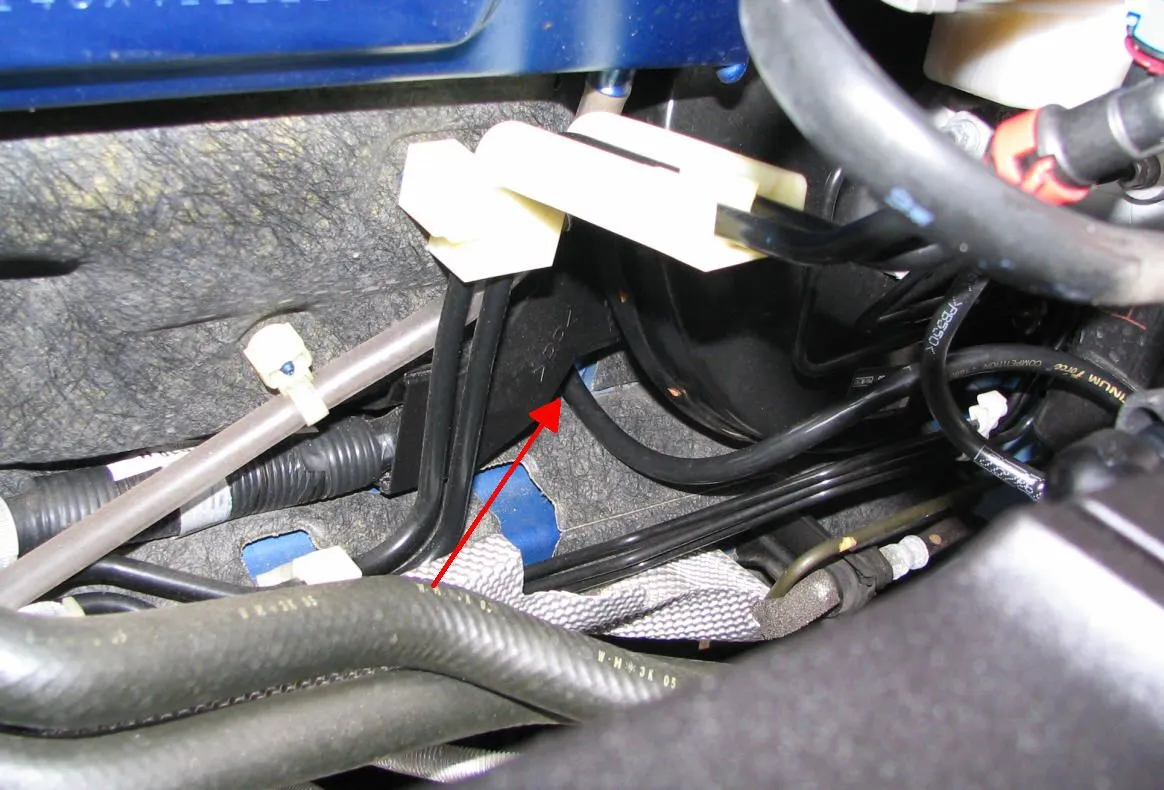

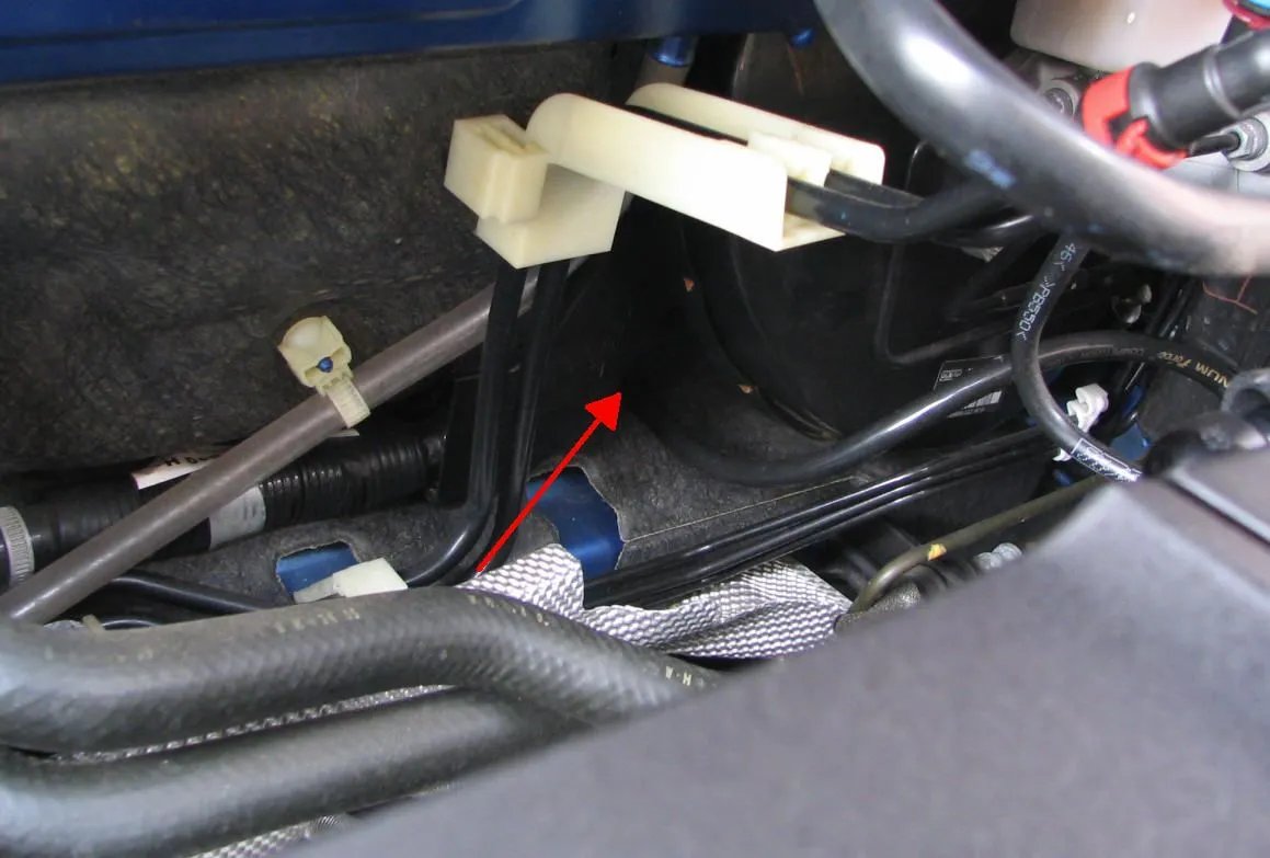

Anyone running a power wire through the firewall might find this useful.
In the engine compartment, just below the brake booster there is a white plug. This white plug plugs a hole that appears as though it may be used for a throttle cable. Since my car (2.3 liter) has drive by wire electronic throttle body, this pre-made hole in the firewall is perfect for a power cable.
The hole will accommodate a 4 gauge power cable with no difficulty, but anything larger than that will not fit without modification.
The pics show exactly where the hole is.
And yes... I am aware that I used black wire for my + power wire.

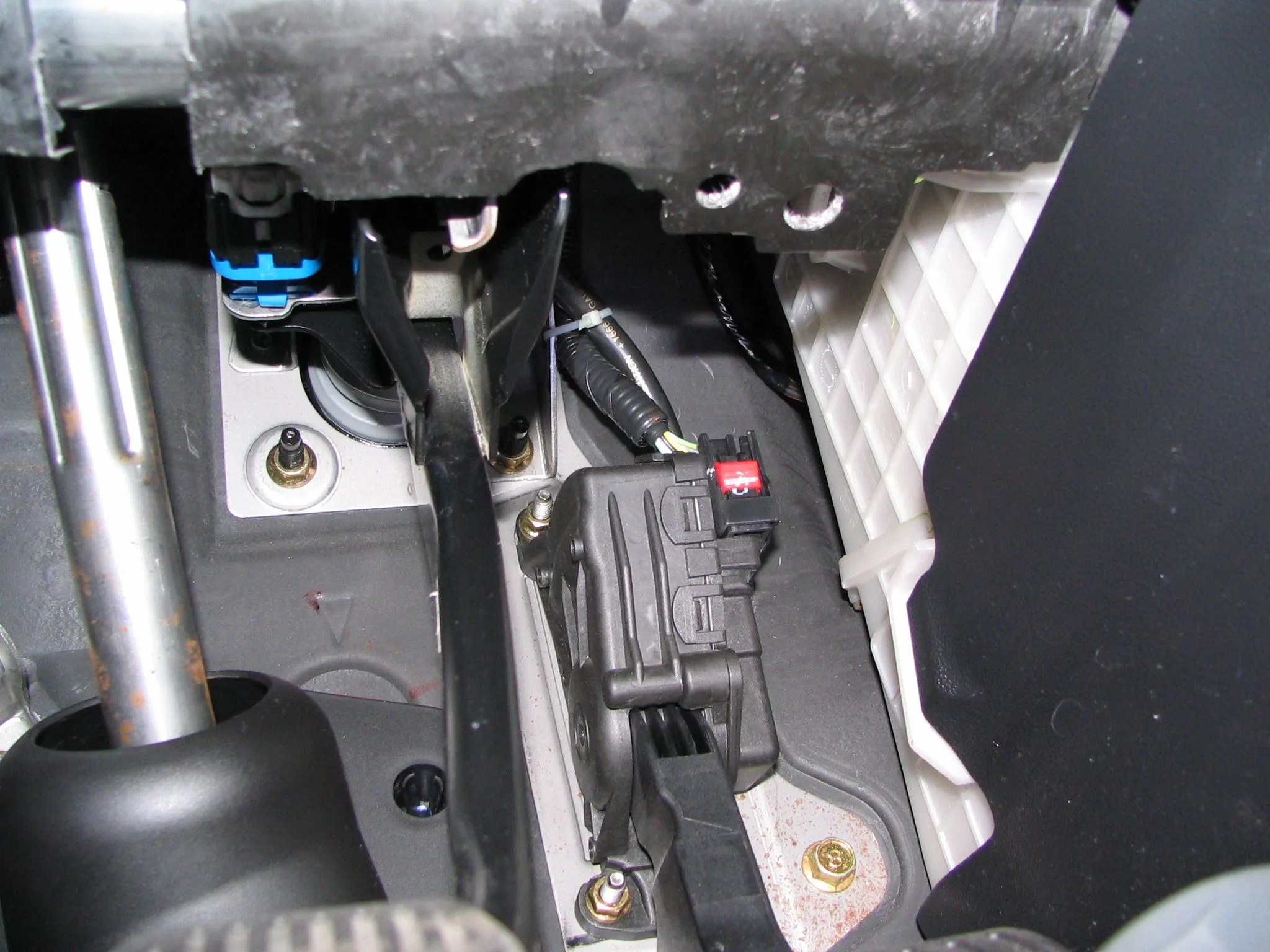

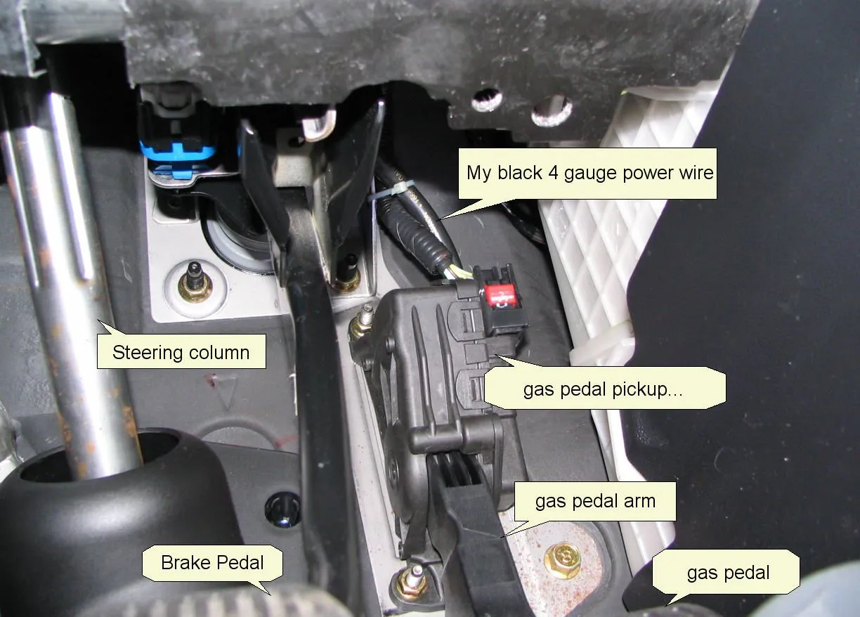

I grab my digital camera and run outside to take a pic of this, got outside to find my car is locked and keys are inside the house. So I run back in to get the keys, then back out to take the pic, turn the camera on and I find that I have left the memory card in my computer... So back inside, for the card.. and finally...results..(see pics)
It comes into the passenger compartment directly above the pickup for the throtle.
I then followed the factory wiring harness up and out of the way!!
