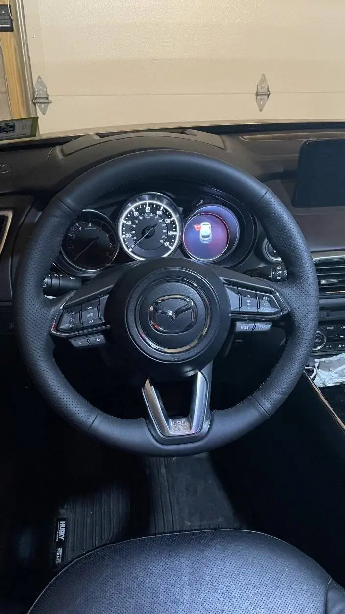

https://www.amazon.com/dp/ (commissions earned) is the one I used. The instructions say to tuck it under the trim pieces on the steering wheel, but I didn’t like how that looked so I took the whole wheel off. Taking the steering wheel off was about 30 minutes and then it took about an hour to sew it on. Finished result:
If you want to do the same thing, I can help with how to dismantle the steering wheel. I couldn’t find a guide online (doesn’t mean there isn’t one, I was just impatient) but this is my third steering wheel I’ve taken apart so I just kinda figured it out
I don’t have any experience sewing, how difficult was it to sew on? I think I’m going to try this first before going to get it replaced.
2016 CX-9 GT
It’s a blunt needle and all you have to do is a loop from one side to the other. There’s quite a few videos on how to sew them on but the leather comes pre-stitched at the edges so you are essentially just connecting those stitches. I don’t have any hand sewing experience either and I did it.
Thanks for this info @MGMGT16. I think I'm going to do this as well. I've got a few minor nicks and scratches on the wheel from my wife's nails/purse I'd like to cover up.
CX-9
I had my wife sew on a $25 leather one from eBay. Came out great but now I've worn that out.
I have a 2015 but it's the same process. We didn't take the wheel off, took her about an hour.
