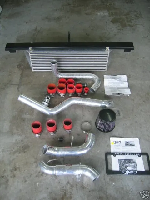

well i guess i dont mind having a perrin intercooler then..because i got mine off ebay from one of the MSP owner...he said it was used for 3 months...it still looks new...he also threw in a injen intake and a hks BOV...for $850 shipped...so i hope i got a good deal..just waiting for it to arrive...
