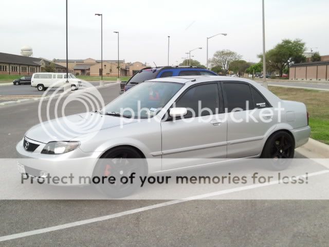

yea i lowered it about 2in all the way around and it rides smooth no clunk noise or anything unlike when i had lowered on coilovers with stock hp the front would all ways bottom out
can you post pics of how low the car is?! PLZ

ok so its been awhile since i have updated on these struts and ppl that keep asking me questions about performance. I personally have to say that these struts perform excellent around turns, sharp turns, u turns, high speeds, hard stops, pot holes and turns at very high speeds i mean i have done pretty much everything to push them to the limit. if my warrant is void by lowering the car then there description on there ebay site is wrong, it actually says works on lowered cars and oem cars which is the reason for buying them.
