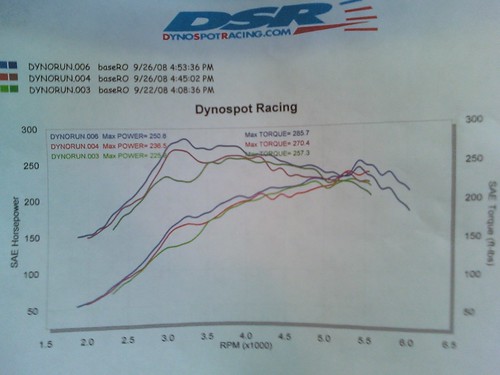

I have both and prefer KNN as Cobb SRI power pretty much useless at such a lower rpm since you just lose traction and power dies really fast. Btw besides focusing on peak numbers you guys should also focus on increase at certain rpms.
Same dyno and same operator in 4th gear since stock but not the same day of course. This dyno was also used on my s2000 where numbers are inline with others s2000's(192-197 whp) so think these numbers aren't overinflated at all.
K&N SRI: 255 whp and 272 wtq
Cobb SRI: 250 whp and 285 wtq
Stock: 225 whp and 257 wtq
K&N peak torque of 272 was higher in powerband(4400rpm) than Cobb where peak torque of 285 was at 3200rpm. I prefer K&N powerband better and now more fun to drive :)
