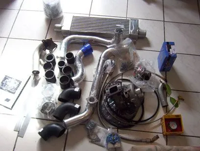

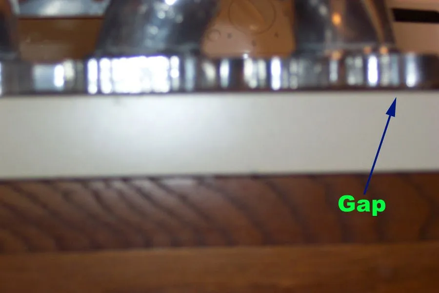

Hey. As you all know, I got my spool kit in last week...there were a few shortcomings on it, most of which Terry sent replacement parts to fix, but I figured I'd post some pics of what I got here...

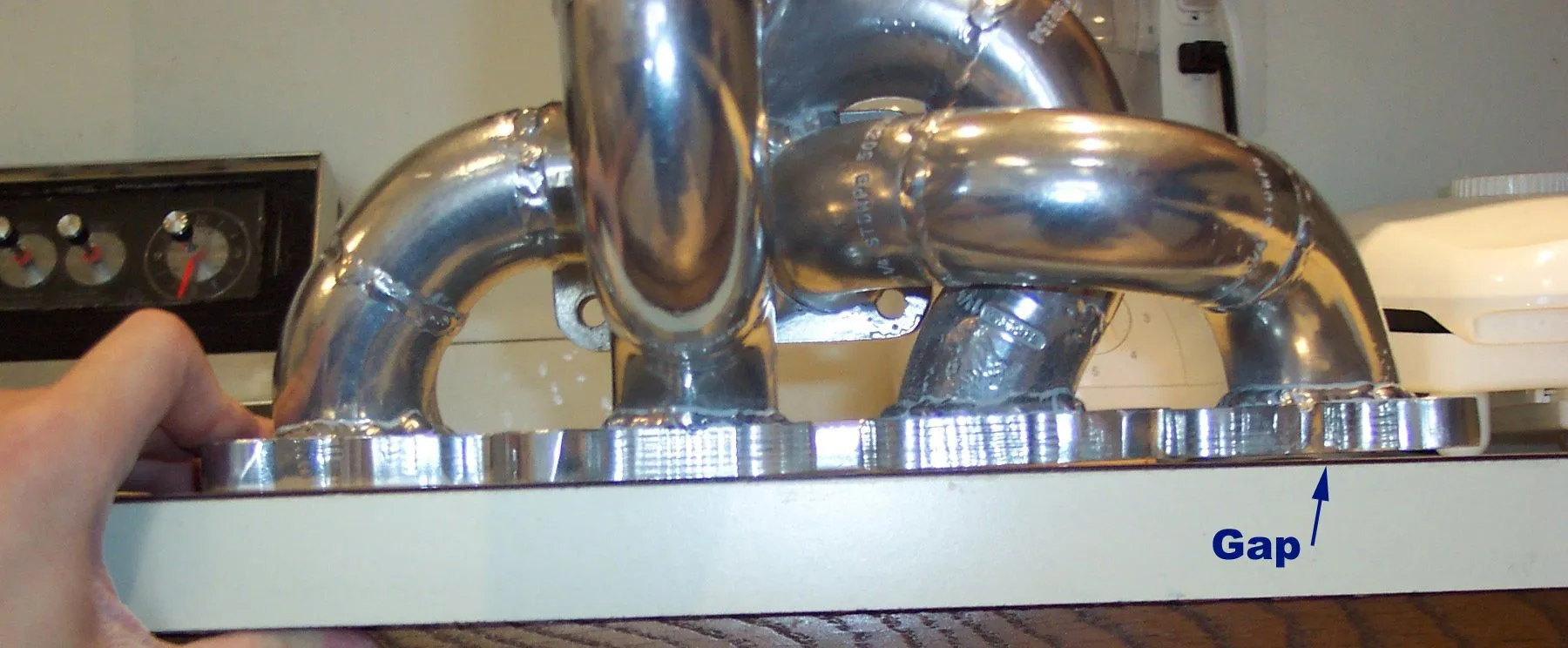

First up is the manifold. I noticed that no matter what flat surface I put it on, it kind of likes to rock back and forth a bit long ways...
Another pic (a little out of focus)

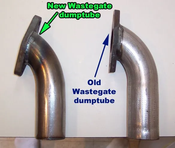

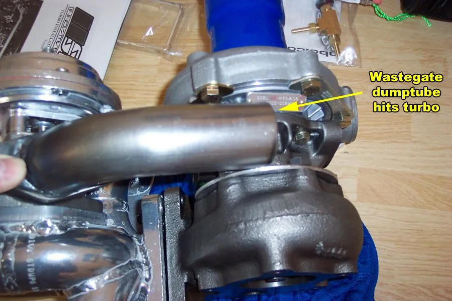

There's another issue where the dumptube from the wastegate hits the center housing on the turbo. Terry sent me a replacement from my original that has a more obtuse angle, but it still doesn't quite cut it...
Man that mani looks #$%^&* AWESOME
I wonder if that could be a problem! :confused: It may fit ok when bolted on the engine.
Can you take a pic of the whole manifold? Im still waiting for mine to start the install!!!!!!!!!
Keep updated.
I had a problem with the dump tube on mine
First I got one for the stage 2 manifold
He sent me another but It would go right through the middle of the downpipe. I ended up cutting off a little of the tube from the stage 2 kit and having a exhaust shop weld an extention on it that dumps out right at the ground.

That main is no good .
I would not put that on you car...
It will crack in time and will be a big pain later.
Have them send you another one....
And make sure it is true.
That is a poor job....
Here's the original wastegate dump tube he sent me versus the newer one, so you can see the difference. I need a NEW new one that is even more obtuse...

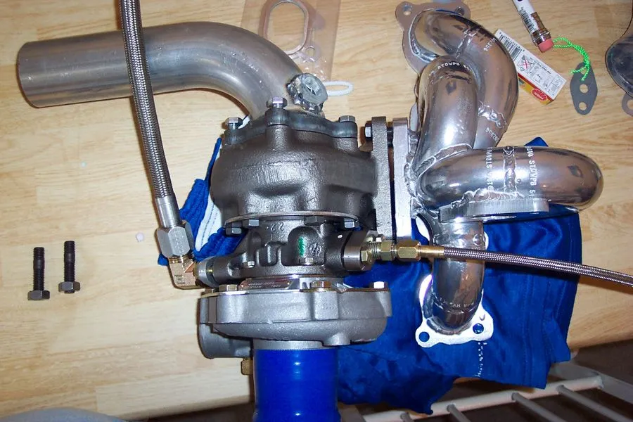

Here's a good shot of everything connected to the manifold. Well, everything with the exception of the wastegate and dumptube. I should have 4 bolts for the wastegate/dumptube, but all the bolts I got are used in this picture...I guess they just fogot to send them.
I should also mention that while I only loosely put the bolts in by hand, the only bolts that felt like they "wanted" to go into the threads were the ones from the down pipe to the turbine. BTW-should there be a gasket between that connection? The kit didn't come with one, wasn't sure if it needed one or not.

Tell him, he will send them.
Im in the same situation, but that is not a big deal, he even sent me more hoses than what the kit needs

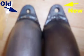

Here's another shot of the newer wastegate dumptube Terry sent out to me...but both holes are threaded, but they're both completely different sizes.

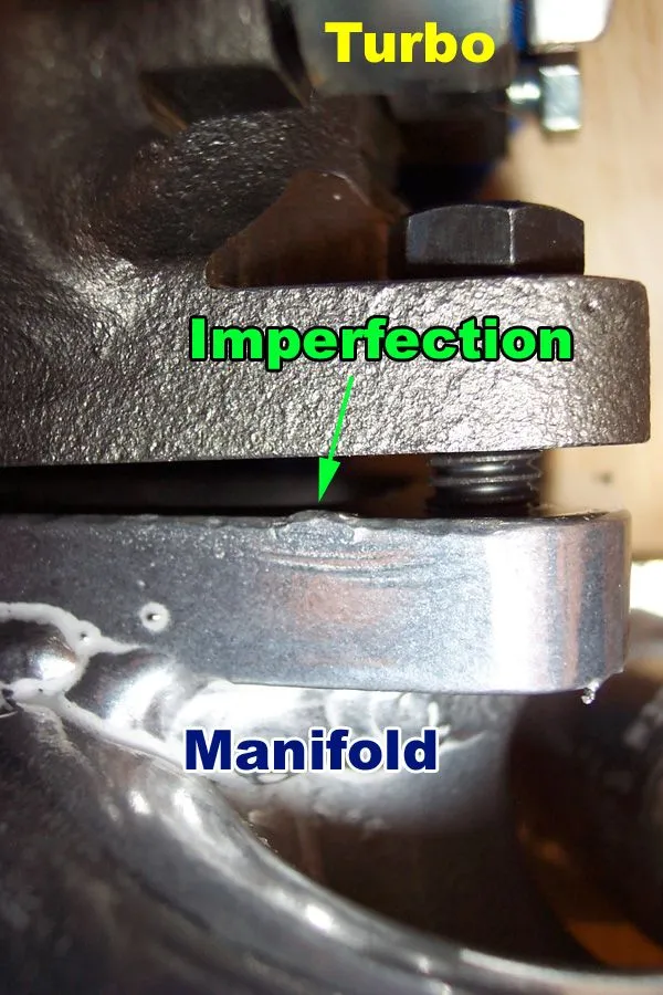

I also noticed that there were some imperfections on the manifold where it meets up to the turbo. Now I know that there is a gasket that goes in between them, but I have a few significant imperfections that I think will impair it from sitting perfectly flat...

Re: That main is no good .
Damn. I need it this week...I guess I'll email terry and let him know so he can start on it.
While we're on the manifold...I don't feel like taking any more pics right now, whenever I showed it to someone they'd comment on the fact that where the tubes meet the "flat" part of the manifold isn't super smooth internally and should have been "rounded off" better. :(
Nope that mani is just fine
In regards to the imperfections on the flange it will work fine as well. Just make sure you utilize a new gasket on the block and torque it correctly

We do not grind or port the manifolds. Justy like an oem application that is casted ect and has burrs If you want that ground down you will have to do it yourself
We are seeming to have an issue with this. We will have to send you another one or like you stated you will get this modded anyways since you are dumping into the downpipe so jest get your guy to cut it and route it to where you need it. However this still needs to be fixed since other people have had issues.
