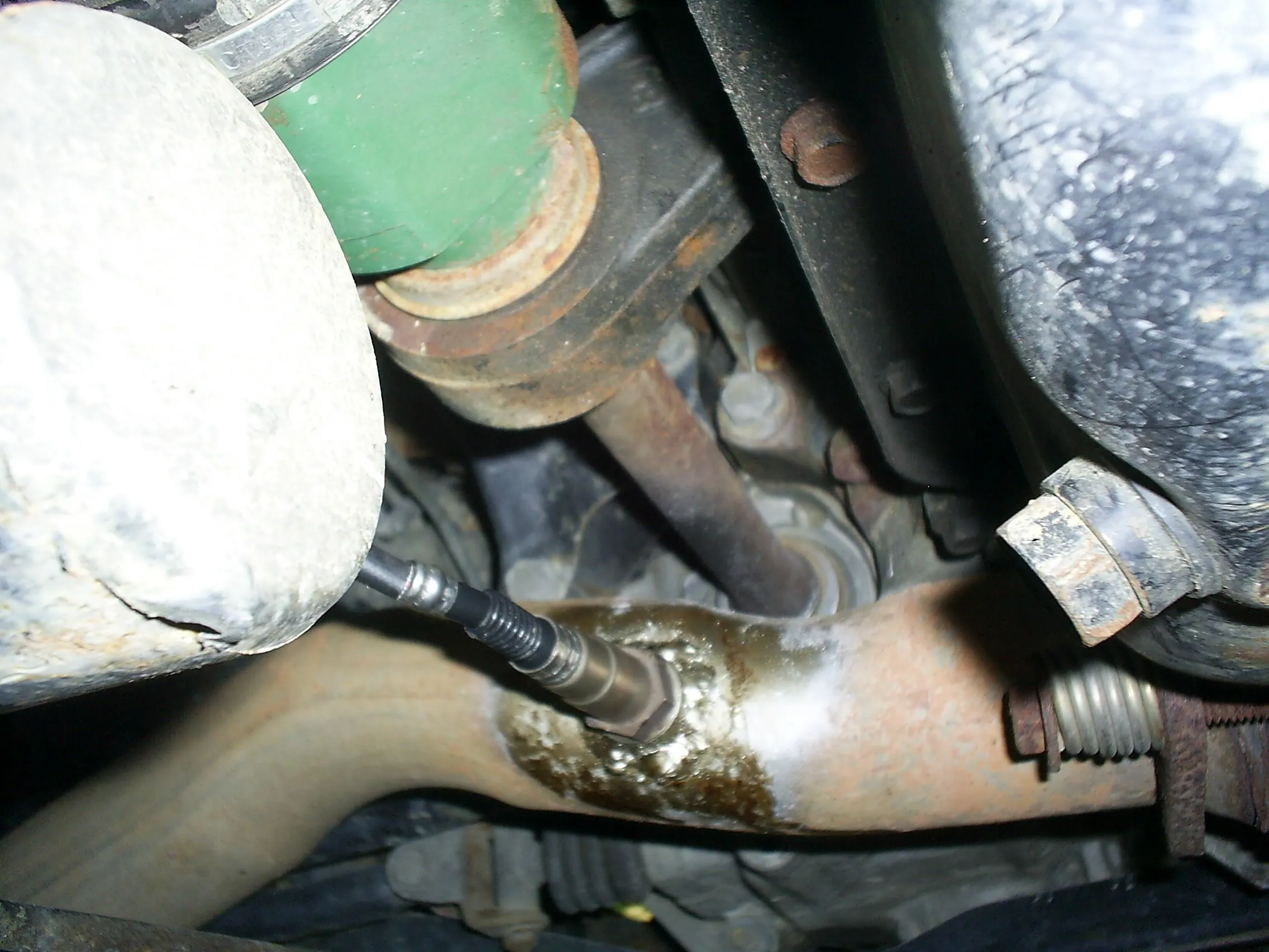

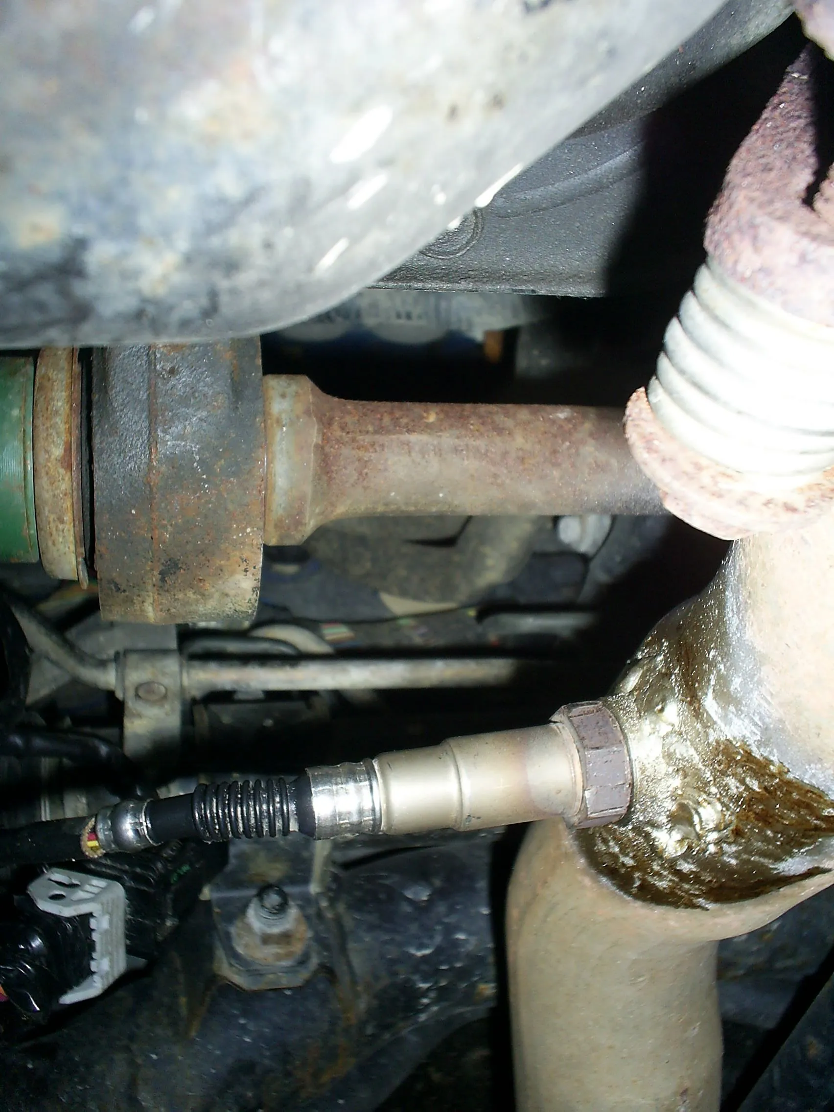

I installed my AEM UEGO Wideband. Maybe it's just b/c it's my first time having a w/b but, i'm worried I either do not have it hooked up right or my car need tuned bad, or maybe it's normal. Below are pics of the sensor in my exhaust. I connected the long wire connector to the sensor plug, then ran through engine bay and into driver side firewall leading to gauge. Ran red to power source, and black to ground source and zip tied blue/white out of the way. I started the car and the w/b did it's loading. After that it was all over the place which I figured was due to warming up. After that at one point it stayed around 14.5, then after idling more it stayed at 16ish. when giving gas it was all over the place and at one point it would go past 17 and then 3 dashes would appear and then back and fluctuate then idle. i have not driven it yet. This was all within a 10 minute period parked in driveway. I'm pretty sure everything is hooked up correctly....I'll be driving tomo to work and will monitor more. Is all this normal mentioned so far?
