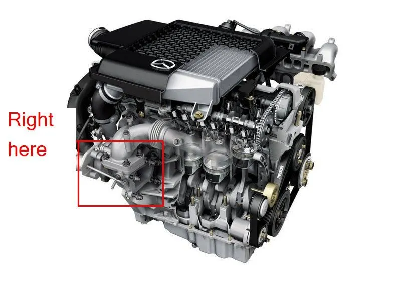

RsxtypeS said:I must be blind, unless this turbo doesnt look like a normal turbo. Where is it in that pic?

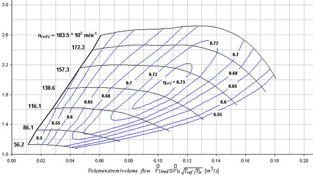

That's incorrect. Your motor doesnt hold boost to redline b/c the ECU tapers it off through the factory boost solenoid. You have confused the turbo compressor efficiency map with the compressor size CFM.ssinstaller said:Wrong.

JDM Sam said:That's incorrect. Your motor doesnt hold boost to redline b/c the ECU tapers it off through the factory boost solenoid. You have confused the turbo compressor efficiency map with the compressor size CFM.
http://www.turbobygarrett.com/turbobygarrett/tech_center/turbo_tech102.html
I suggest you go to www.turbobygarrett.com and do some reading.

Thanks but I know how to read a compressor map and do the math. By the way that math is missing correctional factors for elevation and compressor inlet pressure drop from the air intake system for pressure ratio. If you want to get technical that math isn't as accurate as it should be.ssinstaller said:I've read the garrett site. And I've also looked at the compressor map of the K04--it does not have the flow capacity to sustain 15.6 psi to 6500 rpm on our motor. Here is some reading for you:
This is why the ECM drops boost in the upper RPM band--to protect the turbo. No matter what you do it will NEVER efficently support 15.7 PSI at 6500 RPM.
I agree about the part of blowing hot air after the efficiency limit. From what I understand you are saying is that you can't run and hold boost past the efficiency limit which is wrong. You can make it blow hot air as much as you want. Chipped VW's do this all the time on the K03. The negative being it will kill the turbo faster.ssinstaller said:A turbo that's too small will either not be able to sustain the boost level that you want until your motors redline(that's why our motor doesn't hold boost to redline), and it will be outside of it's peak effiency and will be adding ALOT of heat to the intake air.
