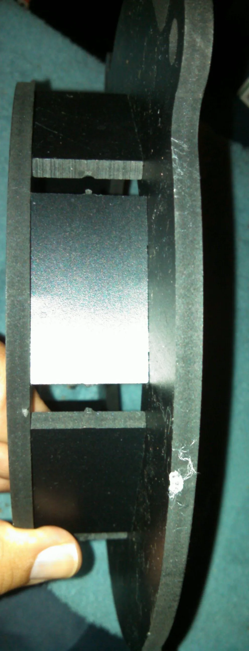

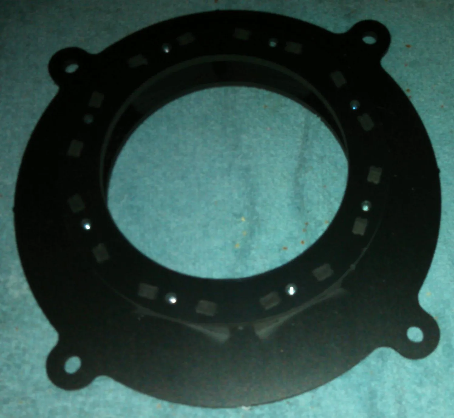

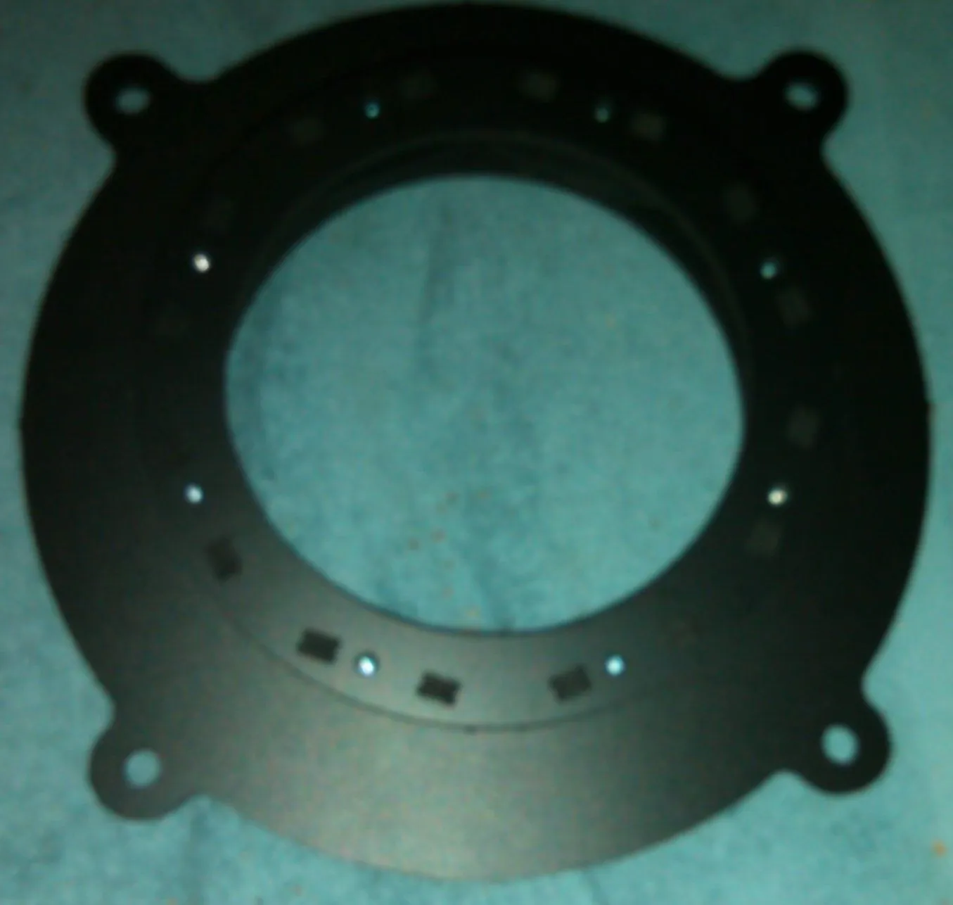

I have a 2014 CX-5 sport. I've changed my head unit to a JVC-KW-AV61BT. I've installed a backup camera and that is where I planned on stopping, but I'm not happy with the factory speakers. I want to change my speakers and to get the steering wheel controls to work. They made a change in the 2014 models and eliminated one wire that the PAC adapter uses to connect them. I've sent them an email and asked when they will have one and the response that I got was that they don't know when. I searched for speaker adapters and couldn't find any and I'm unwilling to gut the factory speakers. I sent an email to www.Car-Speaker-Adapters.com and they are being really helpful. They bought a used factory front speaker off of ebay to use as a model. I really wasn't expecting them to keep asking me so many questions about it. I couldn't answer a lot of what they were asking, but I promised to buy a set of front adapters when they have them available.
Does anyone know if the rear speakers are the same as the front?
Update: They now have the front speaker adapters available and are working on the rear. I've ordered a set.
I got the speaker adapters for the front today. I bought a set of Sony 6.5 inch 3 way speakers hope to get it all installed soon.

Front speakers installed
https://www.dropbox.com/sc/023oe5wp82401ec/K0h08_EQv5
I installed my front speakers. The adapters worked perfectly. I did have a WTF moment when I first held the adapter up to the door. I didn't realize that the holes will only line up one way. When you look at the speaker it appears symmetrical but its not. Not expecting big sound from my Sonys but I expect them to sound better. I was going to put a baffle behind the speakers to keep moisture out but I didn't think it was needed. The design of the adapter won't let water sit there for long. Plus the material of the speakers shouldn't have an issue with a little bit of moisture getting on them. I have to admit I was surprised at how much water I found in the doors. I was a mechanic at a Mazda dealership for a number of years a number of years ago and I don't recall ever finding water in doors like that.
