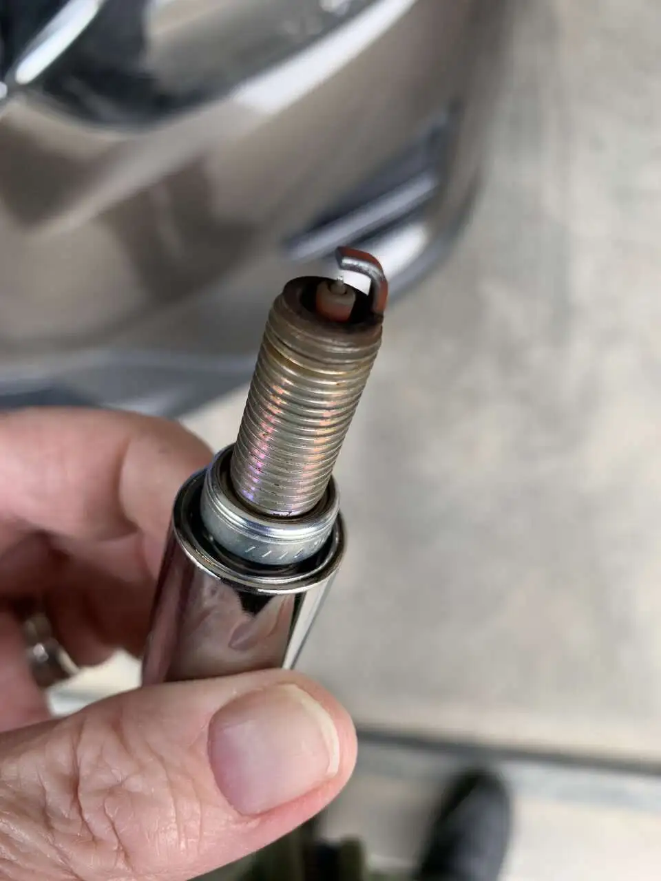

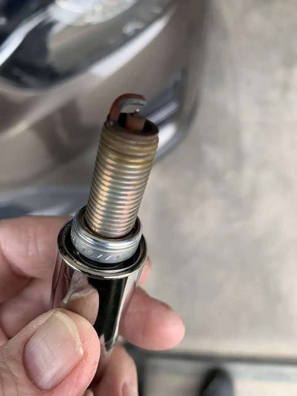

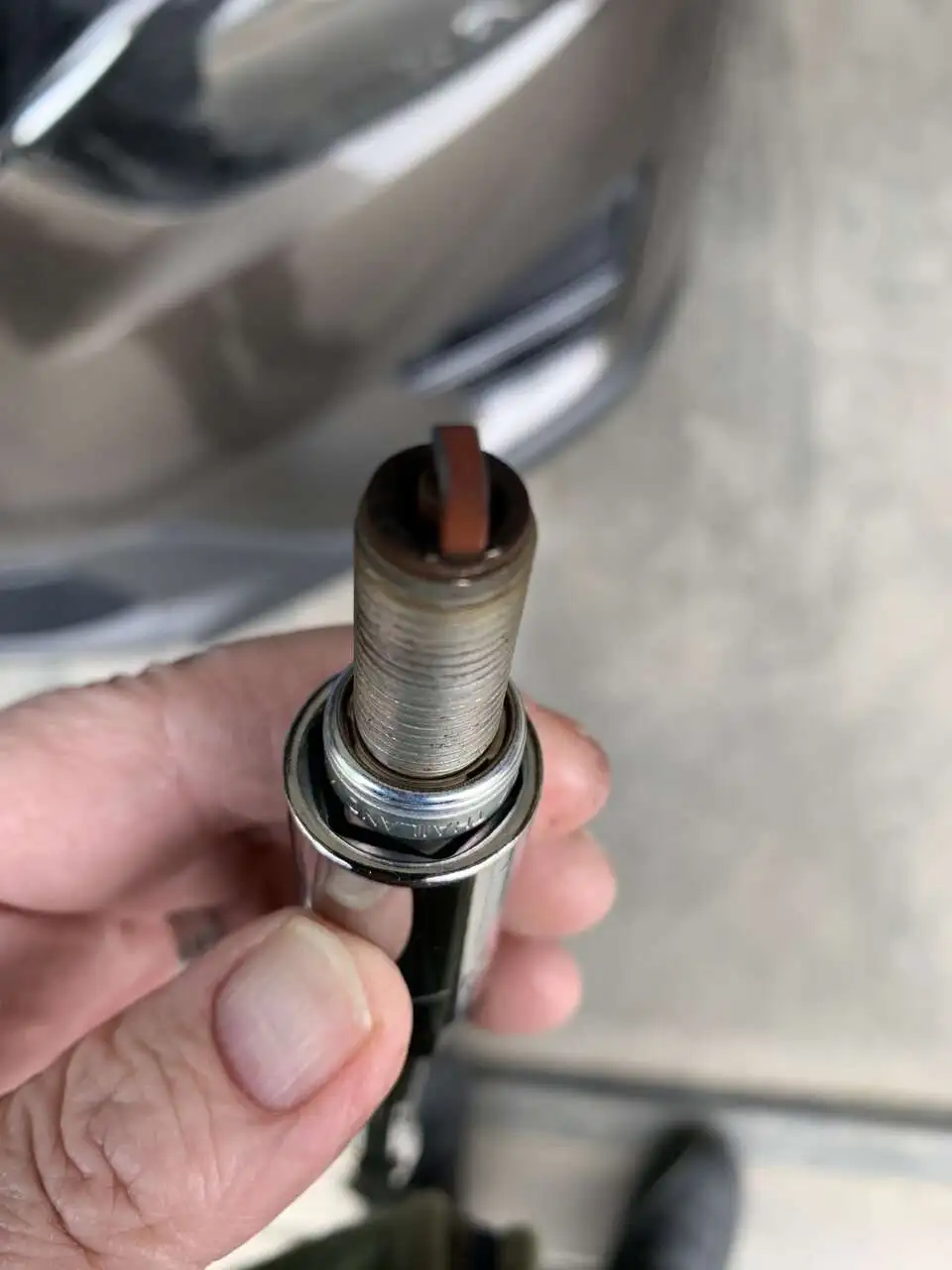

Any chance you still have the failed plugs handy? Id be extremely interested to see what they looked like (part markings, build quality, tip appearance). Thank you for sharing the heads up. I’ve seen many folks firing the parts cannon without realizing the issue was a failed spark plug.
Two of the plugs have a reddish to them and the other two are normal.
The red on the plugs could be due to two things:
1. An octane booster, or any fuel additive that contains iron.
2. Oxides in the fuel system due to fuel system corrosion.
The second reason would correspond with the decreased performance (misfires) you mentioned.
Perhaps you ended up with one or more tanks of fuel with moisture in it, or if you don't drive very often, the Ethanol in the fuel is absorbing enough moisture to cause issues. It might be worth adding Heet, or other fuel system dryer, to the next couple of tanks of fuel.
Unfortunately, I'm guessing your new plugs will end up with the same red tint until the underlying issue is resolved.
Good luck!

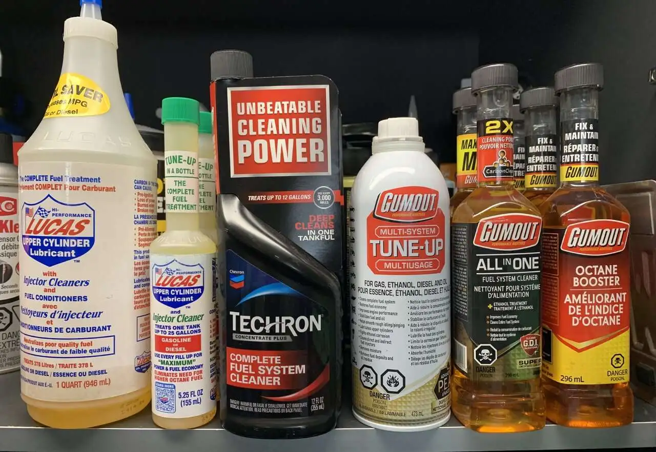

You are correct on the octane booster, when I thought it was bad gas, I put a bottle of Gumout Octane booster & a bottle of All in One Gumout fuel injector cleaner. I put 300 km a week just for work a week, And I usually always put Costco Premium or Petro Canada gas in my vehicles. I do think that I had bad gas and I think that was a contributing issue. Now that I’ve filled twice since that potential bad gas, with new Mazda spark plugs, it’s driving EXCELLENT! I am one of those guys that takes care of my vehicles. Even with Castrol Full Synthetic oil, I change my oil every 5000 km and 90% of my driving is highway. At least every two months I put fuel injector cleaner between Lucas or Gumout 👌 the other day we were in Montana and I bought the Chevron injector cleaner from all the excellent reviews I read. I’ll try next month.
I believe you’re over-done on maintenance. But hey nothing wrong with that if you don’t mind to spend money on your CX-5. ;)
Any top tier fuel is good enough to keep your injectors clean
