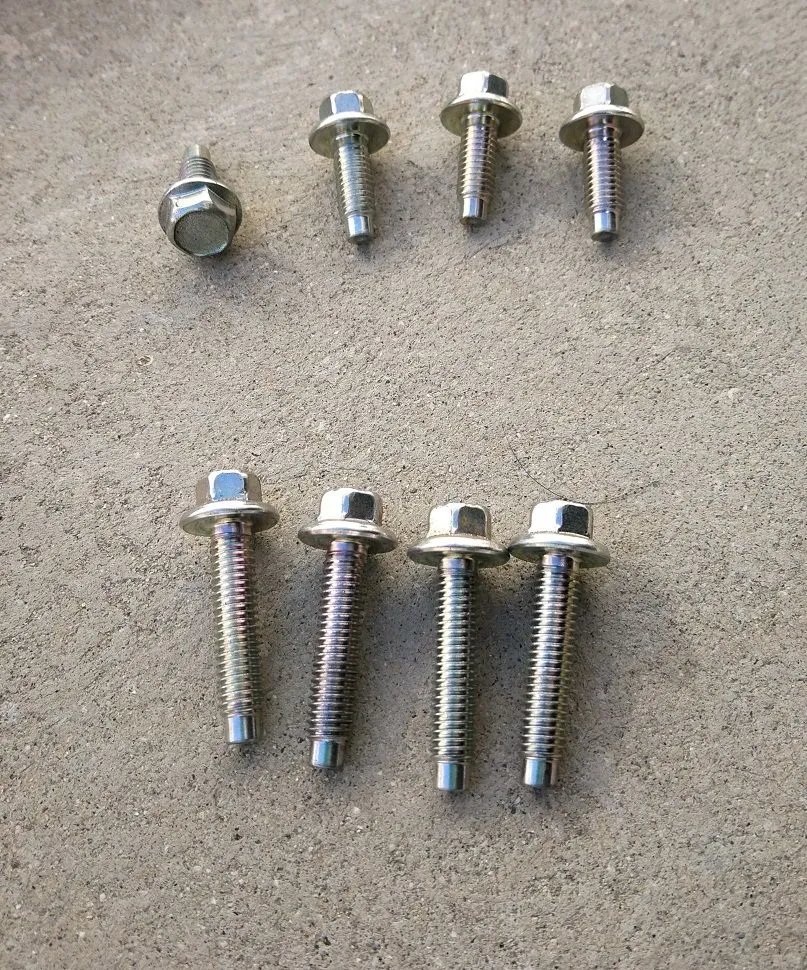

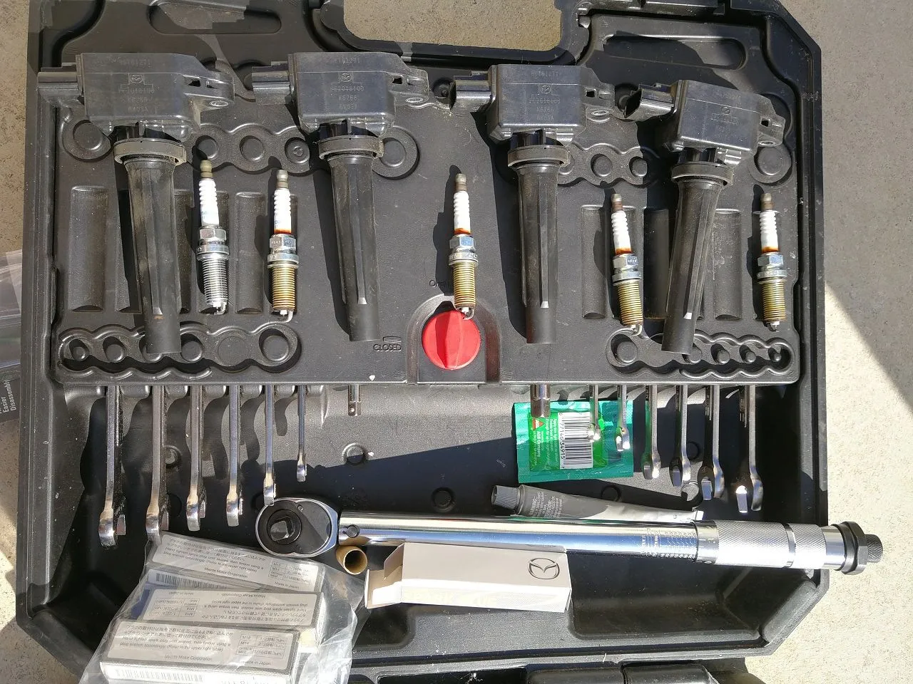

Changed my plugs at 41k. They look pretty good to me to be changed so early. Very simple DIY only need to remove 4 bolts (one 10mm, three 8mm) to have enough room to remove the coils and get to the spark plugs. Next maintenance project will be the throttle body!
