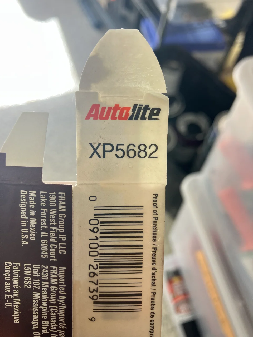

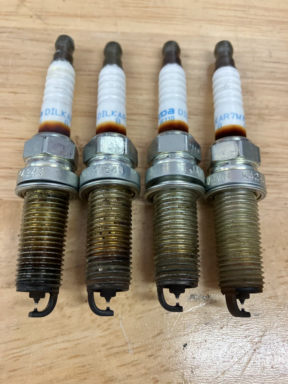

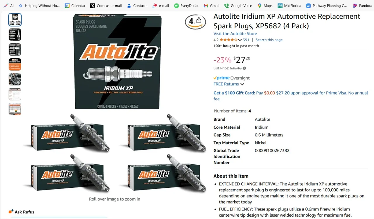

I did a spark plug replacement on my 2020 CX 9 with 53K miles. Here's a picture of the plugs. Not fouled, but was surprised at how beat-up they looked. I used an aftermarket plug, Autolite XP5682. $27 for four of them on Amazon. Car runs like a top.

I'm interested to see how these plugs wear over time. Most people have been using OEM plugs, or the OEM equivalent from NGK (who is the manufacturer of the OEM plugs). Please keep us posted if you notice any changes in engine performance or fuel economy. It's always good to be on the hunt for a more cost-effective aftermarket alternative.
Your original plugs do look beat up, but they were due for change 13k mi ago. Looks like there might be a minor oil leak as well.

I did mine at 50K and they looked like yours. No major wear just a little dirty. Going to let the second set go 75K (if I keep the car that long).
