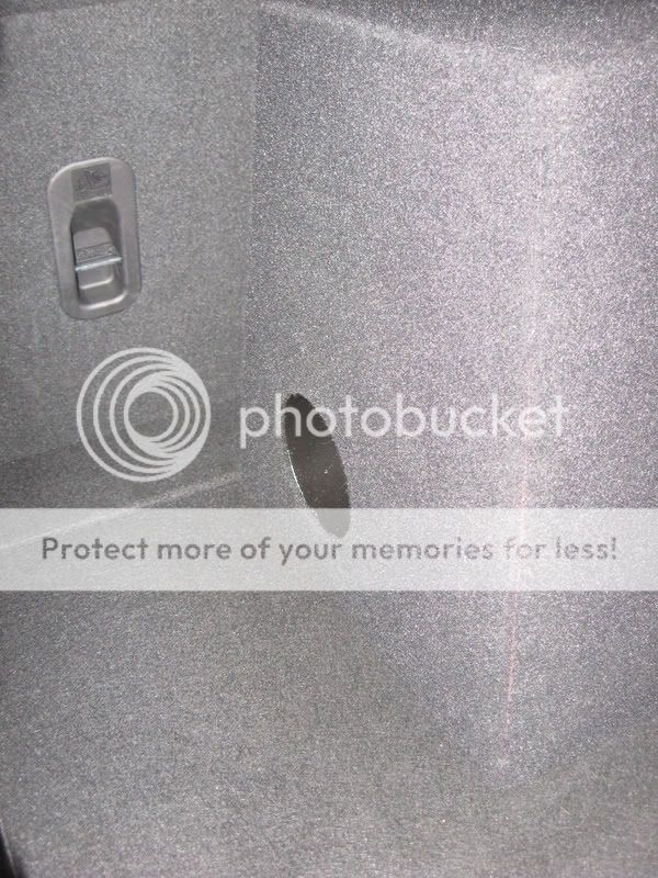

ok, i mentioned in another thread that i wanted to just build one myself. i put it in today; the improvement is AMAZING vs. the sealed 1cube box. i mean, incredible. i put a sheffield labs disc in and turned it up. we aren't talking bass tracks..it's music. the front windshield was moving ALOT. very shocking response with what some might consider to be a little power.
the only bummer is my carpeting job was almost perfect, except one edge and it happens to be the most visible edge, but a little marker took care of it for the most part.
specs are about 2.5ft, with a 4x17" port. the curve is very nice, it's as flat as i could get it w/o any crazy super low hz bumps.
i could have even more hatch space if i wanted, but i have the box sitting ahead of the piece right behind the rear seats, so there is a several inch gap between the seats and the angled back of the box. on a positive note, the box angle matches the seatbacks exactly if i wanted to push it back.
wow, great work!
thanks. i am not entirely happy with the carpet, but i think that will wear off. it's just because it's fresh. i dunno, it seemed like it wasn't as bad when i had it in the garage, but as soon as i put it in the car, it sticks out like a sore thumb. i rubbed some marker on the edge, and it hid it for the most part, but i keep thinking about it.
atleast it sounds good. i have noticed though that if the windows are down at all, or a door open, it gets louder. makes sense, but still.
