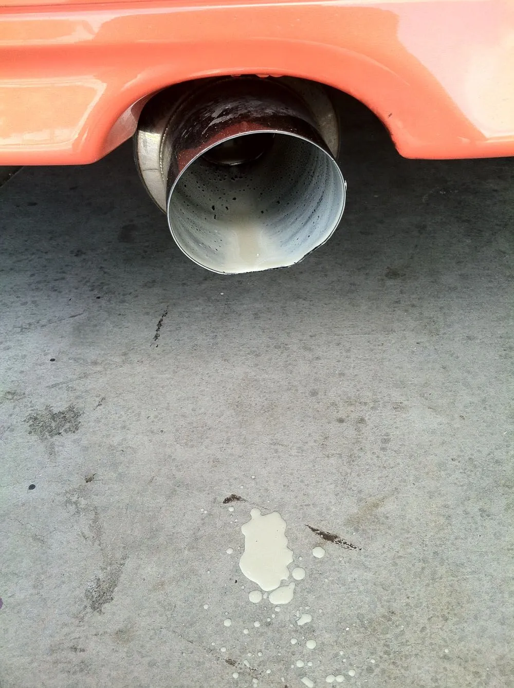

Im having smoke coming out from under the manifold and this weird stuff coming from my exhaust! Whats going on! Bad Head gasket?? photo.webp
Looks and sounds like a head gasket but if smoke was coming from under the manifold it would have to be leaking from there. Do you have loss of power, oil in coolant, or coolant in oil?
I have no idea... There's just that bad liquid fluid coming out the exhaust. I believe it's oil... Maybe head gasket?
Well you know that is not supposed to be coming out the exhaust. Do like Tweety said and look in check your oil and coolant for mixing.
its the head gasket..i just worked on a 4runner the owner cranked it and about a liter of coolent came out. fix it before you warp the head
Thanks for the help!! changed the head gasket. Now I have a leak somewhere. Just sounds like air spraying out or something. Can't find where the damn thing is !! Does anybody have a full diagram or picture of how every vacuum line is supposed to be hooked up on the Intake Manifold?
