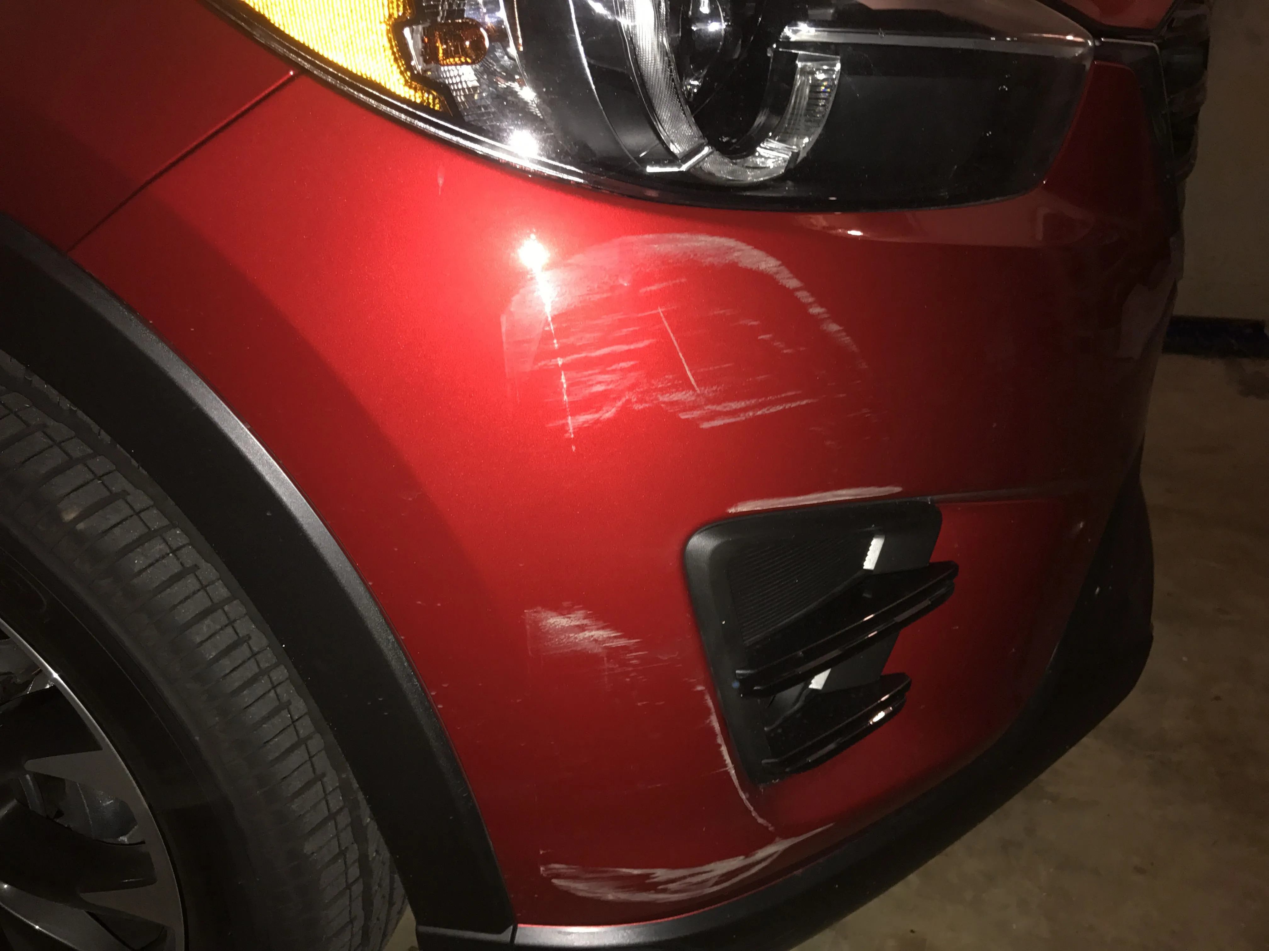

Someone scraped up my 4-month old 2016.5 :(
2016.5 CX-5 GT AWD
Happened while I was parked for literally 20 minutes. Quickest one of my vehicles has gotten ruined. My question is, does this look like it can be buffed/detailed out? Or am I going to need paint/body work? I'm not too knowledgable about auto body

Hard to tell from the picture, is that paint transfer from the other vehicle that's above the clearcoat on your car? Or is it scratches that have gone through the clearcoat and paint to the primer?
I'm really not sure. When I move my finger over the affected areas, it feels raised/rough in nature, rather than nicked. I think the big spots of white are paint transfer, those two white lines *might* be scratches, but I'm really not too sure. I can try to take better pictures outdoors.

Rate won't increase due to this. If you can get parking lot video that's better. Can't see image but for me buffing few scratches and repainting two doors=$750
I'd try a clay bar first to see if you can clean it up.. it can be a labor intensive project but I have had good luck getting stuff like that cleaned up. As long as it didn't go past your clear coat it's generally save able.

If it's above your clearcoat i.e. predominantly paint transfer then absolutely this. I've had good luck with Mother's clay bar kit for removing overspray and tar/bugs. You may need to follow up with a buffer and very light polishing compound afterwards.

In your situation you can seek prefessional help such as Service King if you have one nearby. I do believe your bumper will have a couple of scratches left but it'd look not too bad after the professional treatment without repainting. Try to keep your factory paint as long as you can!

I would first give it a shot with rubbing compound then wax. After that if it's still noticeable let a professional detailer have a crack at it. Most of it looks superficial.
Two months after I purchased my CX-5 I got sideswiped while it was parked. Looks like somebodies mirror scrapped the drivers side quarter panel. It looked terrible. I thought it was a least a grand worth of damage. When I got it home I compounded the crap out of it then wax, then repeat. etc. Finally it looked new again. Only problem was the quarter panel had a slight crease in it, you could see it if you looked sideways with the sun shinning on it. It was something most people could live with but since I knew it was there I couldn't being the car was only 2 months old. Found a body shop close by that wasn't busy, they fixed it for $700 in 2 days. Looked brand new again.

Always start with the least aggressive, and work from there. Cleaner wax>>Clay>>Polishing Compound>>Rubbing compound>>wet sanding>>etc...
It is possible that using just a CLEANER-WAX will be fine to remove the marks. If not, then go one step more aggressive with a clay or polishing compound. If that does not work, I would bring it to a professional detailer or body shop for further analysis.
I had something similar to yours, but looked worse. Cleaner wax and some elbow work on my part took care of it.

I examined it more closely in the sunlight yesterday. I noticed that if I rubbed what looks like that deep scratch on the right, it starts to come off. Since I have no idea what I'm doing with car body products (I've only ever washed and done spray-wax on my vehicles, no idea how to properly do anything else), I made an appointment today with an auto detailer in the area. But, it's pouring out now, so that may not happen today. In either case, I'm feeling better about it now.
I think because the car was new and had a really thick, fresh layer of wax on it (anytime it would rain, the wax would streak on the car, so I think the dealership likely applied too much), it saved the paint. I'm going to have the detailer work on that area and then see for sure.
If you are able to rub some of the marks off then the outlook is good that it is all just paint transfer. There may be some scratches that are left behind when the white paint is removed. If the detailer knows what they are doing they should be able to minimize the look of it quite nicely. Like I said it might not get back to 100% but 90% range is doable. I would start with a clay bar, although those generally aren't meant for removing paint transfer they will help remove any impeded containments in the paint before buffing. Next I would go to something like M205 on an 3" Orange LC pad with a 8mm DA machine. If that didn't do what I wanted I would up to M105 (a heavier compound) and try that. Then move to M105 on a yellow of Microfiber cutting pad and if that didn't work then 3000 grit sanding disk. If you have to go to 3000 sanding disk or even M105 with a cutting disc then you need to go back down to M205 and a polishing pad to bring back the shine and remove all sanding marks or haze from the M105. 3000grit > M105 cutting disc > M205 Light cutting disc > M205 polish disc > Wax > Done! to start to remove follow that in reverse order but start with the clay bar. An Dual Action machine will make work much easier and faster but can be done with good old elbow grease. If you cant find M105/205 Meguiars Ultimate compound and Ultimate Polish are very similar in cutting ability and can be found much easier locally. Good Luck!

Detailer was able to get 99.8% of it out. Only thing that's left is a small nick that's really hard to see, where the paint is actually nicked. I could try covering it with the OEM paint pen, but overall I'm very happy with the results. I have to see if I can get some of the marks off of the black plastic trim, but the body is unscathed otherwise!
