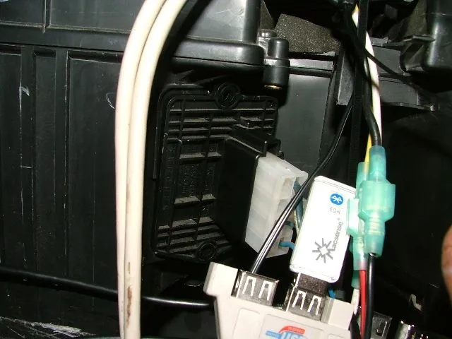

Bill, would you be able to tell us where this resister is installed, or provide a picture?

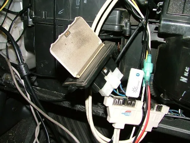

It's easy. Take off your glovebox and there it is. 2 phillips screws. I just cleaned mine instead with alcohol, fixed it. Rather than buying a new one.

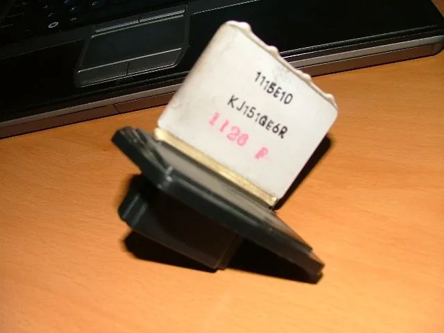

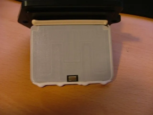

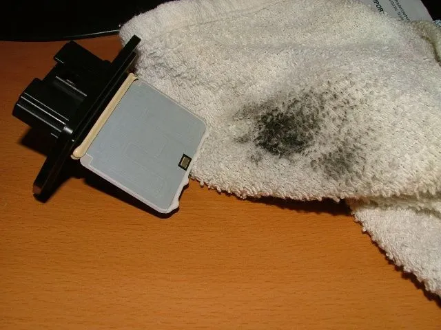

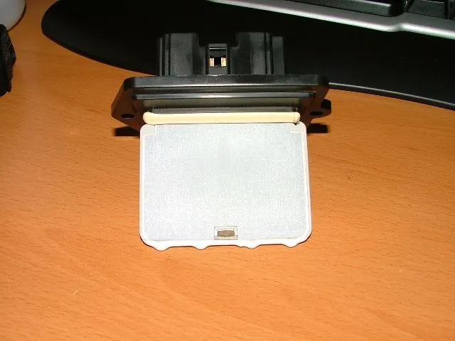

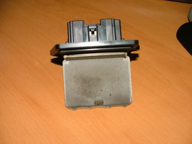

Ok, so I took it out, and it was dirty. I cleaned it with a towel, and some alcohol. I also used a Q-tip to clean the plug contacts. It looks much better. Before and after shots are included.

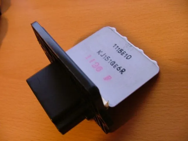

A couple more closeups:
