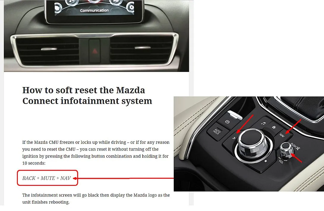

My display did not turn on this morning, checked all the fuses (all good), seems like the radio didn't shutdown properly.
Found this online and it fixed the issue (sort of like a CTRL-ALT-DEL function), thought I would share and help someone if they encounter the same issue
You have to hold all 3 buttons down simultaneously for 10 seconds minimum.

I read here that you really only need to hold mute + nav [back not req'd] for 10 sec.
Don't know if it's correct-- haven't had to try it.
It's sad that I have this memorized. I use it once every other month or so when the screen goes blank, or the backup camera doesn't come on.

Yeah, me too.. But I'm glad Mazda at least provided an easy fix like this and save a trip to the dealer and not get ripped off.

(1) Soft reset: NAV+MUTE for 10 secs
(2) CPU Tool: MUSIC+BACK, Do it again to cancel
(3) Engineering mode: MUSIC+FAVORITE+MUTE (enter codes to get info)
In the worst case, shut down, and restart.

Thank you so much. It worked right away. I am so happy that’s all it took.
Just found out about this fix today. This not only affected the radio but power going to my front & rear dashcams that are powered via the cigarette lighter port. At first, I thought my dashcam was defective after having it for over a year. But yesterday when I was leaving work and turned on my '18 CX-5 Sport, for the first time, the radio screen was blank even though music was playing through my smartphone via USB. Does anyone know what the dealer charges, more/less, to update the infotainment software?? Thanks to @blackcx5 for the fix.
