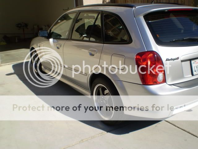

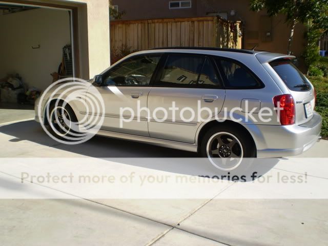

heres what youll achieve by working a a oribital polisher (like the PC7424, i use the UDM) youll never achieve these results by hand. its physically impossible. i think forcefed, you used an orbital buffer, and not a polisher, because i cant see how anyone would hate work with an orbital polisher. its easy to use, and with a little elbow grease yields great results.
before
50/50
done
