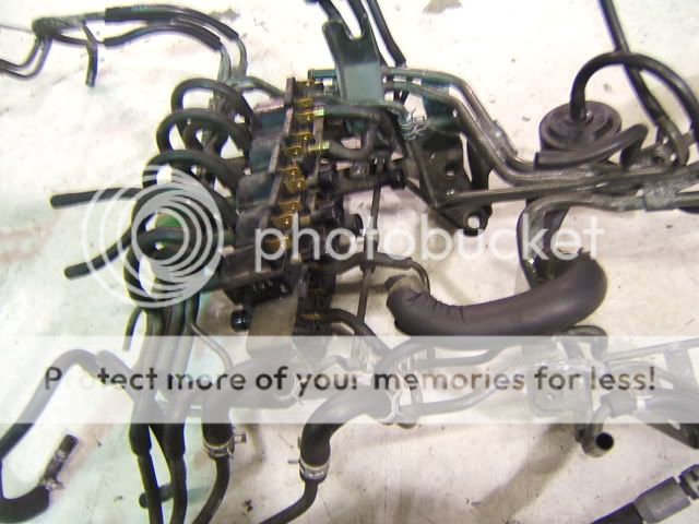

So what exactly is the "rats nest" then? I thought the ACV, air pump, BAC and stuff were a major component of it so if I wanted to keep those I really wouldn't be removing anything. The problem at RX7Club is that there are so many n00b threads asking about this you can't find the original. Once you find something remotely useful all the picture links are dead and it's from someone who removed everything.
rats nest is just that a nest of metal lines that route under the plenum to connect like 10 different hoses.. (vac hoses)
many can be capped off on the intake
it is all about emissions
the air pump is a BIG HOSE that goes directly to the intake that u will leave.. the rats nest is for smaller vac hoses that feed the other solinoids etc u dont need.
all u do is run the the couple hoses u need form the source to a place on the intake (so u have a couple CLEAN vac hoses) and not that big rats nest laying there.
here is a pic of your rats nest (looks like on a 3rd gen 13B REW) but would be similiar
