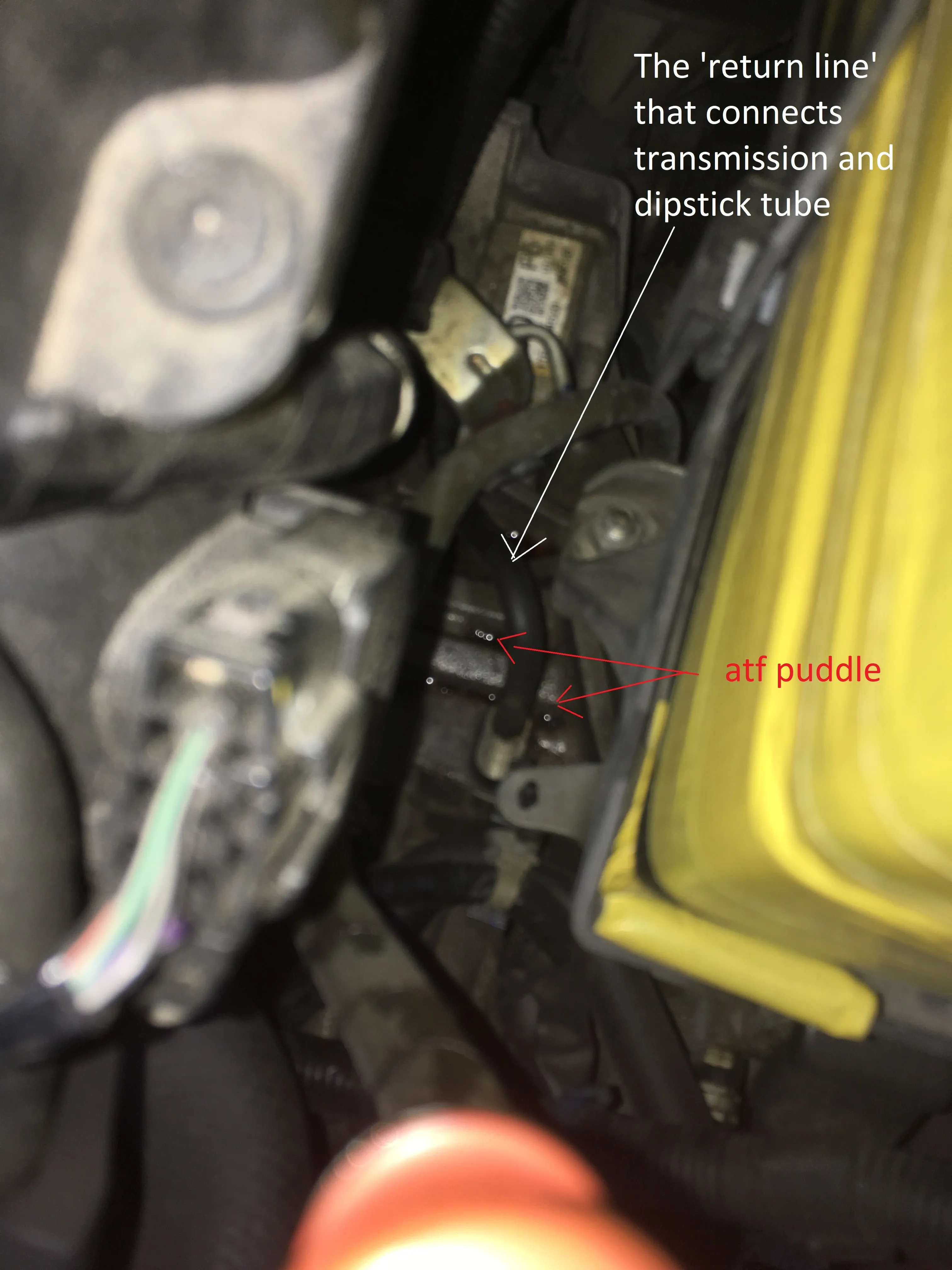

Yesterday, I went on a trip of ~100 miles with heavy car (4 people in car) and lots up and down of hills, but all highway. And today I checked the atf level again, and found a puddle of pink fluid on top of my transmission(please see the attached pic and the red arrow in the diagram)...

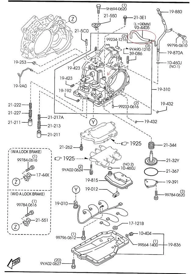

I checked around, and found two likely source of leak: 1. Atf blown out from the dipstick hole, or 2. leaked through the 'return line' that connects the transmission and dipstick tube (part# 93-4405, on the diagram, the diagram may not be for mazda2, but that's the closest I found).
I'm just wondering if anyone has similar experience with atf leak on the top of the transmission? Should I just clean it and see if more fluid would leak out? or bring it to a mechanic and check in case of further major leak?
Also, just wondering what dose that 'return line' on the dipstick tube does? Since there is no clamp on the end of the rubber line (unlike any other line that has metal clamps on both ends), it doesn't seems to be able to hold much fluid pressure, so could it be a 'fluid release' line in case of atf overfill....?

My gut tells me that you just overfilled it and some leaked out at the bottom of the dipstick tube.
The bigger thing is, how many miles are on the car, and has it ever had its transmission fluid flushed? If you're over 30-40k miles, get it changed out (a full flush, which takes about 9 quarts). Experience has taught me that Mazda's automatics tends to be hard on fluid and that regularly changing it will go a long way.
Hello DrWebster, thanks for the reply :) The baby has ~20k miles on her, the atf is still reddish. I'll do the drain and fill around 35K or before that and keep an eye on the color. I cleaned the leak and went for another ~100 miles trip (today) and found no leak yet ~ However, the fluid level is still above the head of the dipstick... I'll keep you updated if there is anything else unusual :)
