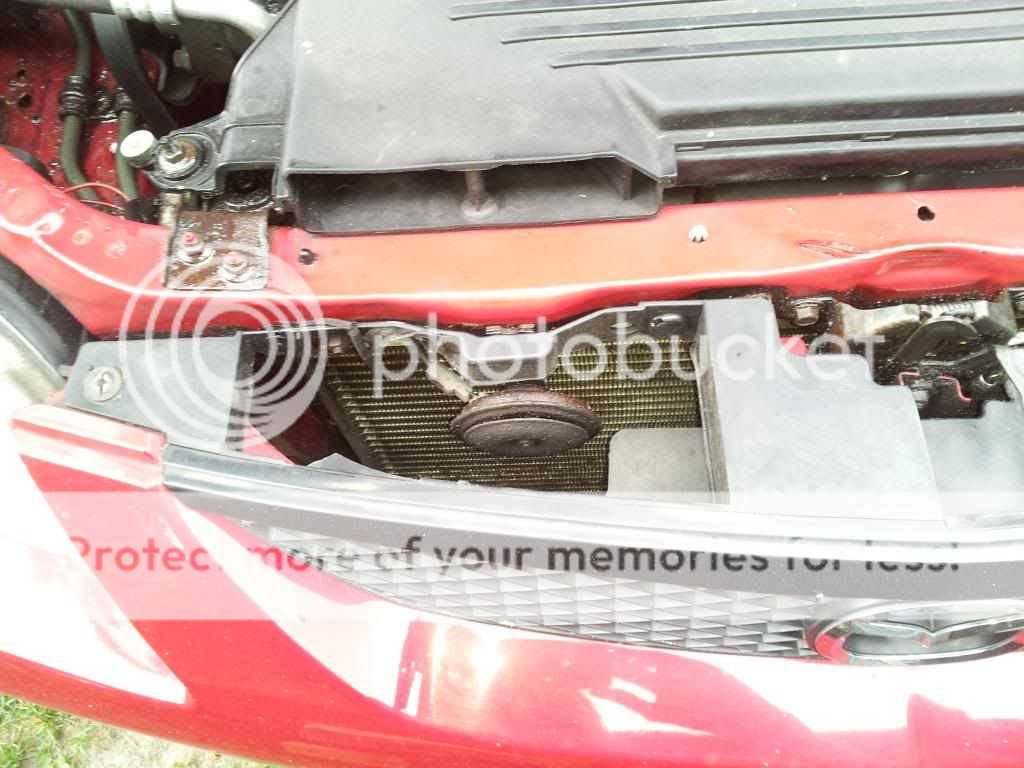

I did this to my intake,... it's supposed to give a ram air effect.
It's free and easy and can't hurt (unless rain gets forced into the intake but that hasn't happened,.. there's drain holes in the intake system)

I cut my grille like that too when I had my P5, never noticed any difference in MPG, power, etc.
I can't say I noticed anything either,... I just figure if it makes any difference, it's for the better. (shrug)
