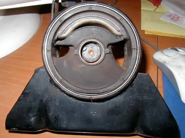

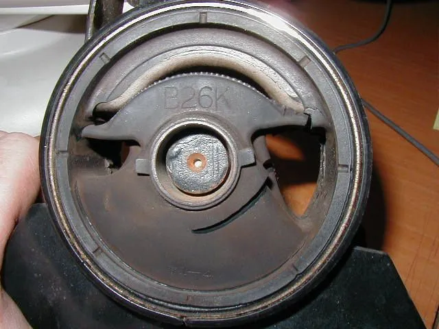

broken passenger side mount
here is an example of a torn passenger side mount
both pics are the same mount
It looks fine until you twist it.
I suspect that I have at least one torn mount. I'm at 42k miles and am noticing a lot more engine movement, both when i start the car and when accelerating in 1st gear.
