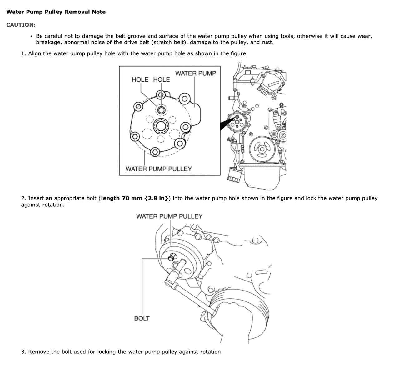

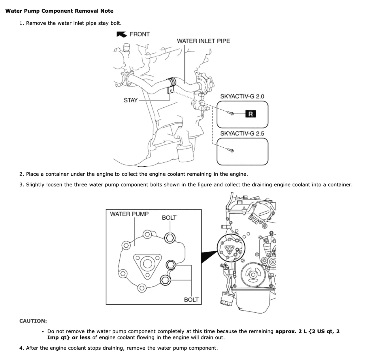

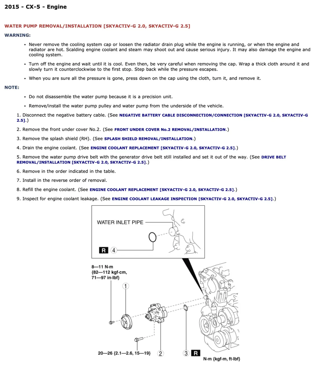

Off subject, what is the water pump life on the 2.5l?
Our last car, 2.4l Honda WP was still good at 120,000 miles. On the other hand the WPs on a 5.9 Cummins is 50 to 100k. I own a spare WP for the Cummings and carry tools. I'm on my 3rd WP after 265k...
