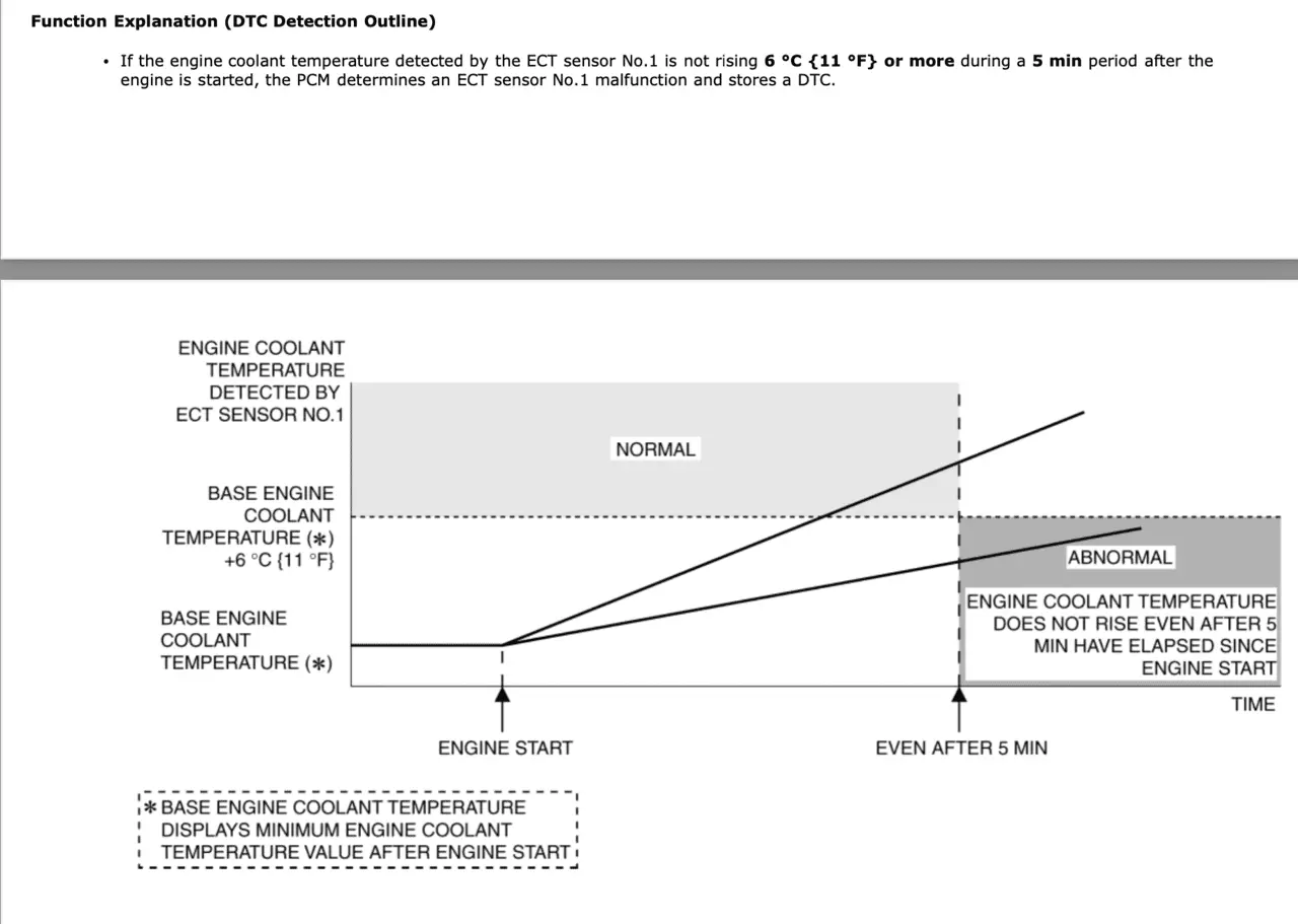

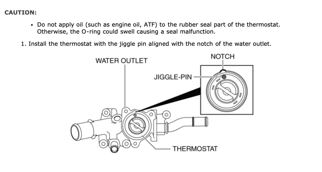

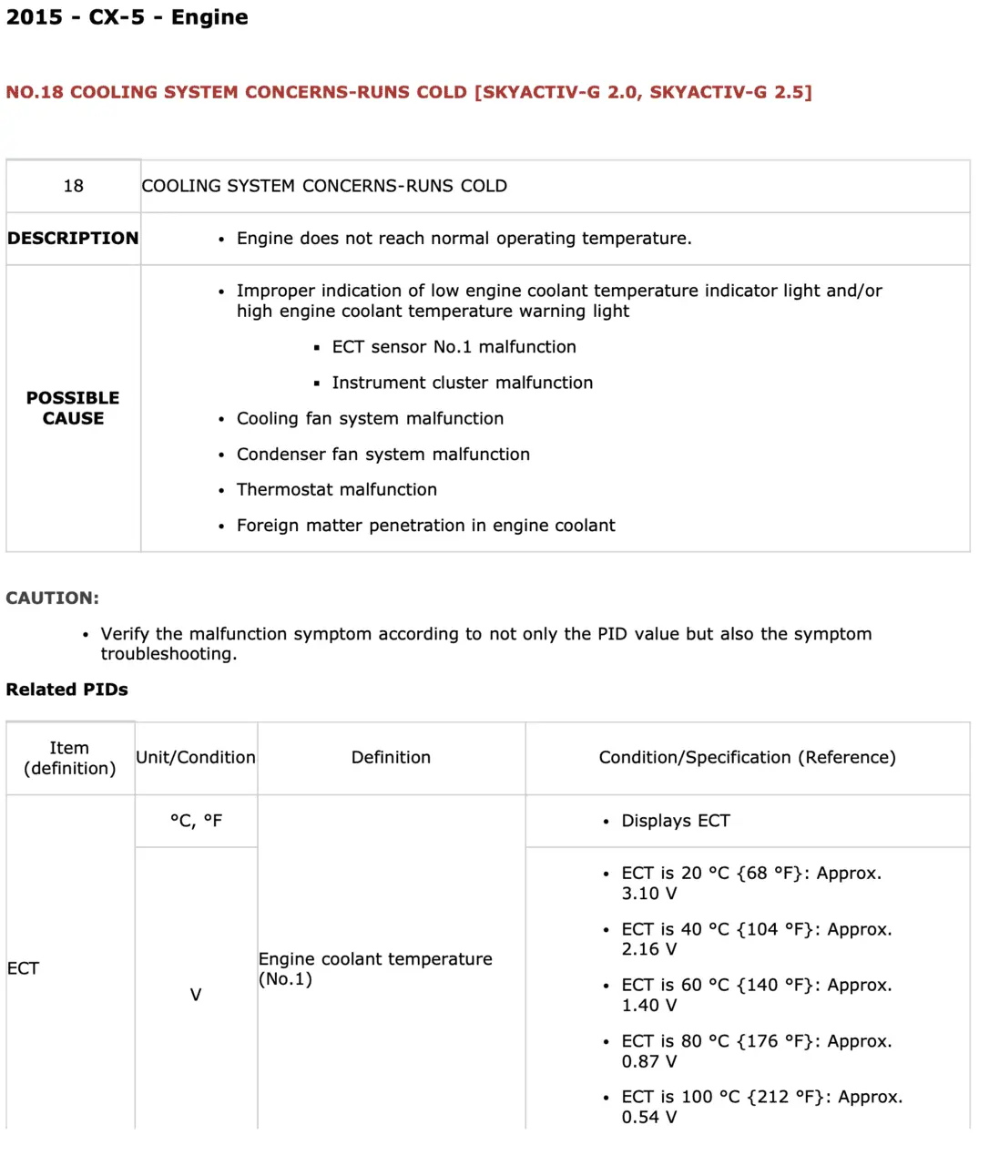

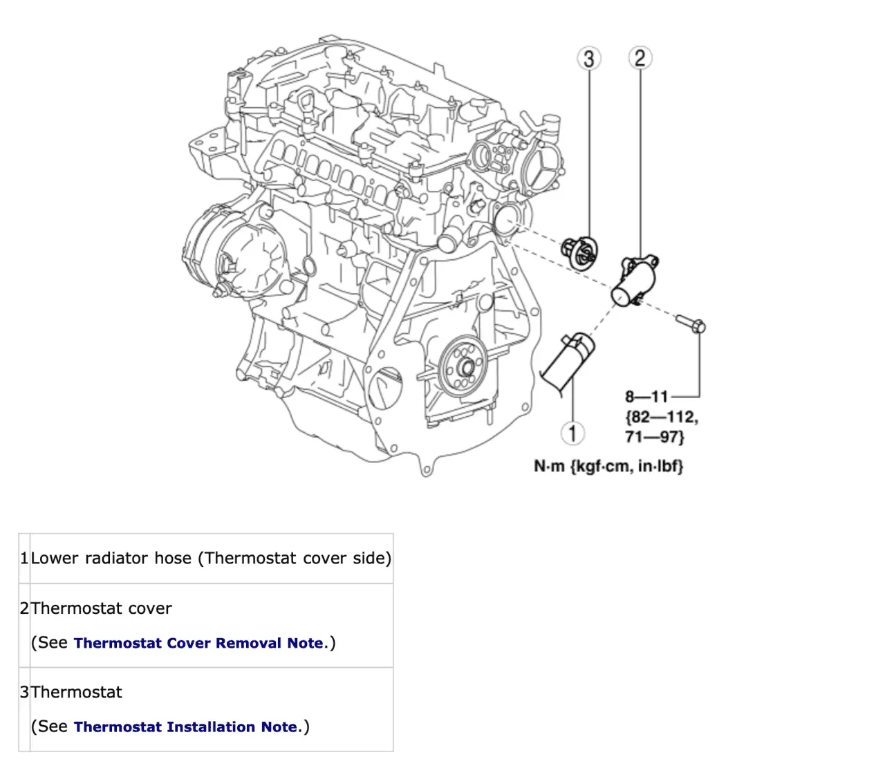

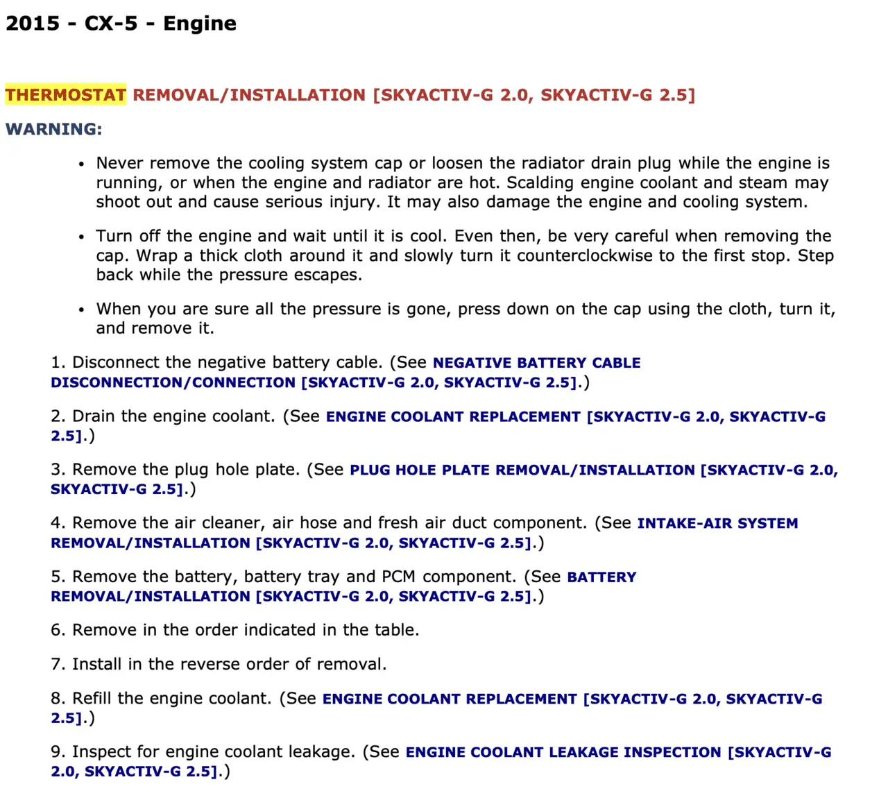

FSM for my '15 shows
Thermostat initial-opening temperature
80.5—83.5 °C {177—182 °F}
Thermostat full-open temperature
95 °C {203 °F}
Thermostat full-open lift
8.5 mm {0.33 in} or more

Kedis82ZE8 > thanks for posting. I plan on flushing / replacing the coolant in soon (along with the t-stat) so appreciate the instructions. I will also hook up my pc based OBD2 and see if I can get a read / record over time the temps fm start.
