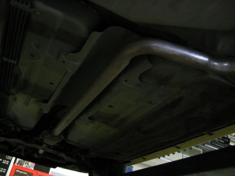

I have a rattle also. Its because the piping is not centered correctly on my car. Its off to the right a bit and when I hit bumps or something it hits the sides of the groove.
It gets really annoying at times. It actually sounds like I am dragging something on the street. Bah!
I had my installer check that out, and low and behold...thats what it was. The solution was a small rubber piece with a clamp tightened on it on one of the upper muffler hanger to keep the muffler and piping from moving to the side. A slight bending of the heatshield directly above the second resonator also helped big time. It was a perfect solution IMO because it did not involve any cutting or fabricating. No more rattling noises. A big thanks to J.R. of Gateway Mazda in Aurora for his help and a big thanks to his crew as well for the great customer service.
