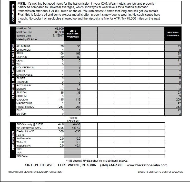

Anyway I did my first transmission fluid change (3 drain/fill sessions a week apart) starting around 71,200 miles. During the first, I captured a sample and sent it away for analysis. And before you ask, yes I wish I had started this closer to 50k miles, but oh well. I have driven over 3,000 miles since these services and no adverse affect.
Here's the report:
Thank you for doing this. Wonder if you could post the results on BITOG, it would be would be quite interesting to receive comments from the community there. I do not remember many results for Mazda ATF posted there. With your permission I can do this for you, if you're not a member.
I also wonder where did the lab get their averages from. Normally the data comes from the fleet management programs, but I highly doubt that's the case for Mazda. How many of the private - sourced analysis on a fluid like this they might have done...
I wondered about the averages too.
You have my permission. I am not a member there. Just link me whatever thread you post in. :)

Reposted mine here in effort to consolidate. Thanks ColoradoDriver. 51k, also did 3x drain/fill after this sample was taken. Anybody feel free to share or repost my analysis as you see fit.
EDIT: changed to Imgur link png file instead of pdf. Hopefully this works better
Plotted some of the data in Excel: specifically Aluminum, Iron and Copper vs mileage. Blackstone's 20k average number was used as one vehicle. The other vehicles used were mine, ColoradoDriver's, and Mike_R's. I did a best fit check on the data. Exponential regression was the best fit found (you can see from the limited data we have that the wear level does not appear to be linear).
The R^2 value is basically a measure of how well the trend line accounts for the data observed. For example, if the number of miles driven is considered as one of the variables causing the amount of aluminum present, the data shows that the trend line (aluminum vs mileage, exponential effect) explains ~44% of the effect we are observing (not a very good fit). It doesn't explain ~56% of the effect. The fit was much better for Iron (~81%) and Copper (~73%) vs mileage.
This is very limited data, so I don't think you can take a whole lot from it. Right now it suggests transmission wear might be exponential. BUT, we only have 4 vehicles. You'd want 30 or more before you start hanging your hat on statistical analysis. If you exclude ColoradoDrivers data points, the level of wear actually looks much more linear than exponential (ignore the last set of dots plotted just after 70k).
Clear as mud, right? :D
I can revise it when new UOAs are added. If wear metals are the cause of future wear, the data suggests a snowball effect. Changing at approximately 70k or sooner looks like a good idea if youre ever going to do drain and fills.

I think most interesting for me was the difference between the 67k report and mine at 71k. I do drive my CX-5 pretty spirited, maybe why it was worn more? Who knows.
