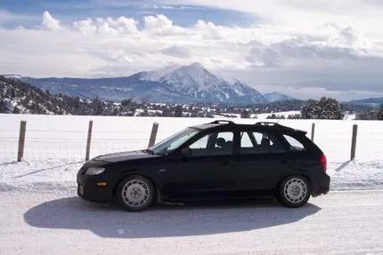

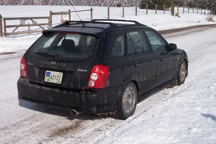

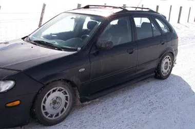

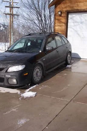

i have skunk2 coilovers on my car now for two years.. they pop a little now and then but i fixed that with some homemade spacers.. they will slam the car if you like, mine is normaly tucked an 1/2in in the rear and 1/4 mabey in the front.. the fronts are 3/4 the way down and the rears are 1/2.. now im on the winter set up with the rear fully rasied and the front up a 1/2 inch.. ill tell you now that the coils fully rasied are about 1in lower that stock front and about 2 inches in the rear.. im still on the P5 shocks, though i had the msp shocks on for a short while.. the ride was a little better with the msp shocks but the shock tube is a little longer so you cant lower the car any without rideing on the bump stops..now back on the P5 shocks an it rides fine to me, though it can get bouncey at times.. iv been driving cars with race springs for 12 years now so im used to it.. i like the car low, i can tell a differance in the control, stablity, and grip at max driving on backroads and autox..added the AWR 21.5mm rear sway bar and the corners like a dream on my 215/45/16 azenis.. i think the skunk2s are a good for the money if your looking to balance the car and drive it hard, like autox.. if your looking to lower the car and just have a near factory ride than springs and maybe shocks would be the way to go.
some pics of the car in winter mode, dirty, snowy, as it sits as of yesterday.. the rears are all the way up and the fronts are 3/4 or so the way up.. the tires are taller so its tucked still, but not so much if the factory 16s are on.. those 15s are old maxima wheels, lots of offset, so much so that i have to camber the s*** out of the rear just to clear.. thick rugged looking wheel, rally style :).. still gets around fine on coilovers in weather like this as long as thers not over 10" or something..
