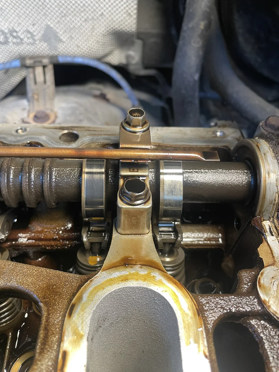

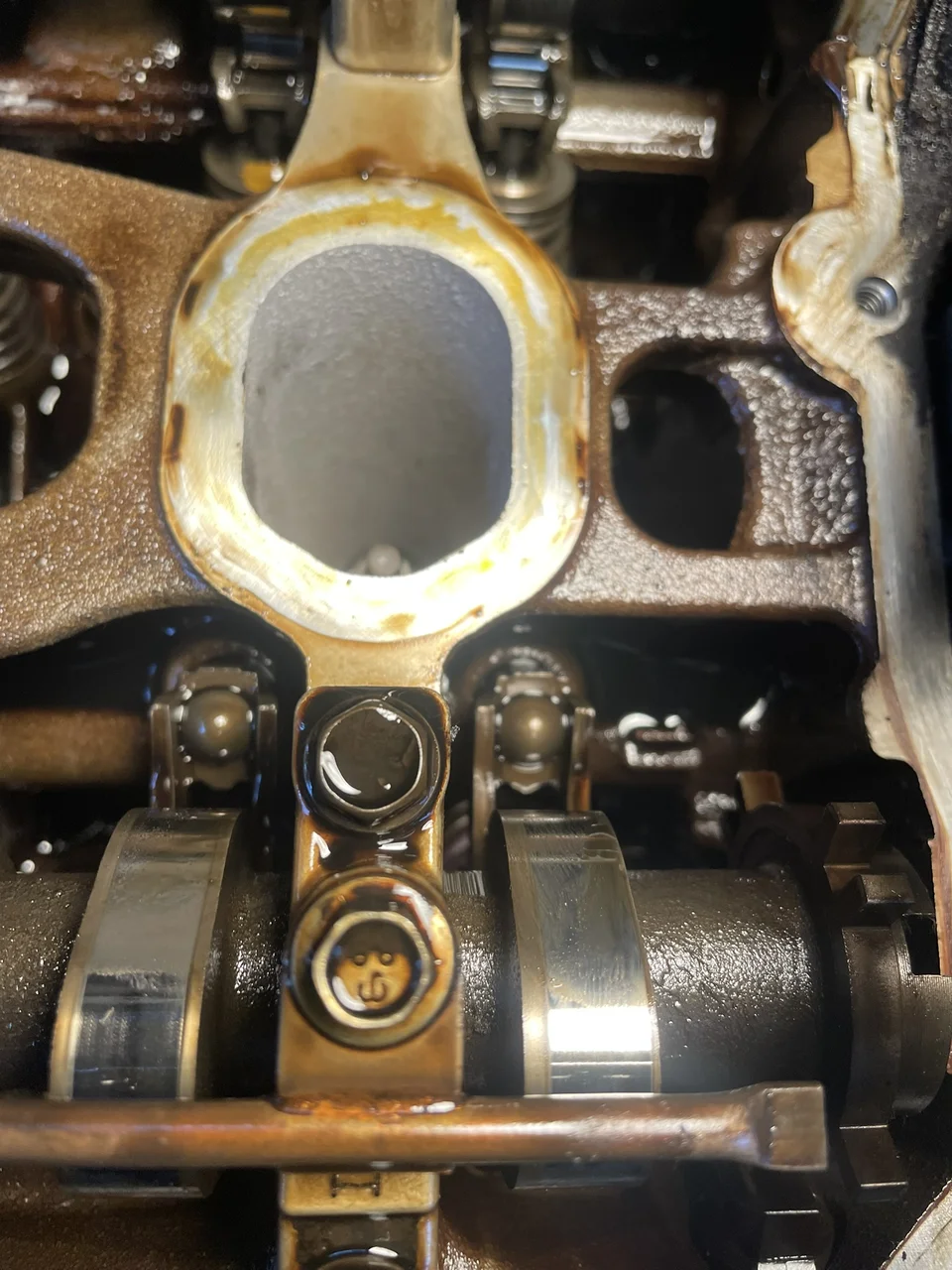

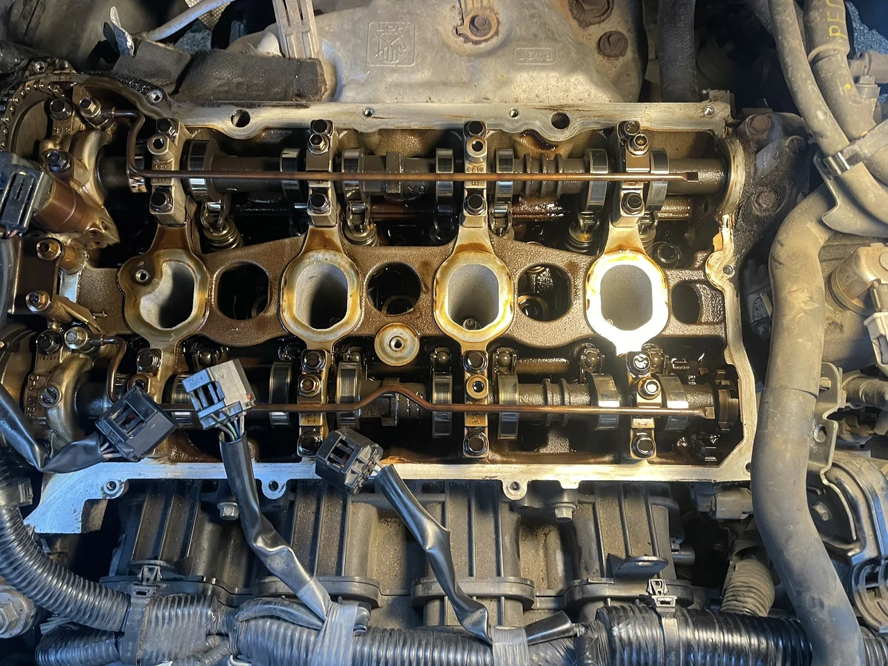

Spent the evening taking off the valve cover. Boy was that gasket rock hard. It's a wonder it didn't weep more! Honestly, I'm pretty pleased with what I'm seeing. No sludge. No burned metal. no grooves on any of the cam lobes or rockers that I can see. The engine has never been overheated or oil starved. Hard to believe this has 316,000 miles!
Next step will be a leak down test in the next few days. Then I've decided to go ahead and pull the head. I'm encouraged by tonight!

I'd be interested in seeing all the pics you want to post of a 314,000 mile motor. I'd like to see how much carbon buildup the intake and valves have. Following along.
Will do! And just for anyone interested, we bought this car used at 22k miles. Since then the engine has never been apart, or had any special flush or anything extra-ordinary done to it. The only thing I've ever been strict about is always using full synthetic oil. I've done most of the oil changes myself and have always used Mobil 1. Also, as previously stated, this is my wife's car. She has to drive a lot for work so I'd honestly say 90% of the miles are highway miles, and not easy ones. She doesn't baby her machines! This engine had all original ignition (I think I replaced the plugs once, but the plugs I pulled out today were Mazda branded), injectors, and accessories. I did have to replace the belts this past year after one finally broke.
Other than that, the only things that have broken on this car have been normal wear items like tires and brakes, one blown out shock, and control arm bushings and ball joints. Like I said, best car I've ever had!
