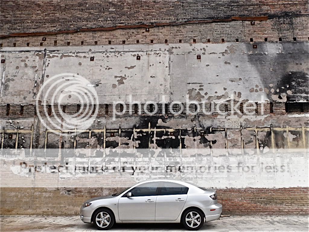

P9269001 by -FaM-, on Flickr
It is there to protect your doors from other small cars, but the main door culprits are SUVs and Vans...their doors hit way above the side moulding so it renders the moulding useless most of the time.
Where I work, I can't risk it. Lol. There are idiots that sometimes park way too close to my car, or are just ridiculously stupid to be cautious of other cars.
Nothing's happened to it yet, but it's bound to happen.
Best is to heat up the whole strip a little, the goop comes off a lot easier, mostly sticks to the moldings themselves rather than the car. I recommend the gel Goo Gone, peels the left over goop right off!
Just dont try to use fecal material...totally doesnt work.
Awesome...you must post pics of her now...err....the car. My car is a female but are chicks cars female too?
