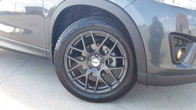

What are the specs (rim width an offset) on the 19" Nurburgrings and tire setup. That looks like a good fit. I'd like to go similar in size. The tire size looks like it fills the wheel well a little more.
That is my tire+wheel set up. The wheel is 19x8", offset I believe is 35; it may be 40, Rodrigo from Font has to chime in on that. Tires are stock size, 225 55 19 Nitto NT412Q's.
So far I love them. The weight difference with this tire+wheel combo is very noticeable when accelerating from a stop and when braking. It feels very light on its feet.
