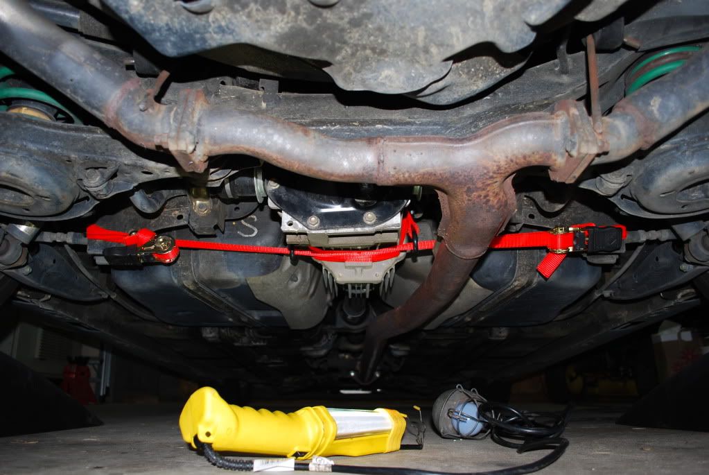

I just added straps to the rear differential this morning and what difference. Something temporary until I throw out 500 bucks for mounts.

Do the straps/mounts make a difference in launching or driveability?
Don't know about the straps, but with the mounts control of the rear is much better. For instance, I can now get the back end to step out slightly (without the TCS kicking on) making a turn from a stoplight, where before it wouldn't do anything.

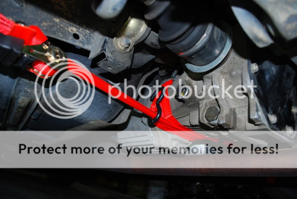

Qwik 6 can u post up how u did the straps and maybe take some pics im interested in doing this too but cant find a thread on it anywhere, btw ken has a deal going on CP-E stuff over in the PG section on this forum i already pm'ed him about a rear diff mount u may want to as well..
Are we allowed to link to another forum on here? Since I got all my info from other guys on another forum.
I bought $15 straps from autozone. Rated for 600lbs. I strapped the differential from both sides. I hooked it to the bottom of the frame where the suspension is near. Wraped the straps around the differential twice from each side. There is a wire on top of the differential. Most people didnt move it. But I found it very neccessary to move just not to chance the straps piercing the wire. Which was easy. Just cut it from the clip and there was plenty of slack to pull it towards the back and out of the way.
I will say this did make a drastic difference. Especially when taking off. My dif. no longer makes a loud clunk shifting to second. After driving it for 2 days one side worked its way snug to just a couple of clips and its very tight. The torque is much more instant when you hit the gas.
I dont have any pics right now of my current set up. I do of the old way which only lasted 15 miles since I had it wrapped around the swing arm if you call it. And the suspension going down pinched the strap and it came off.

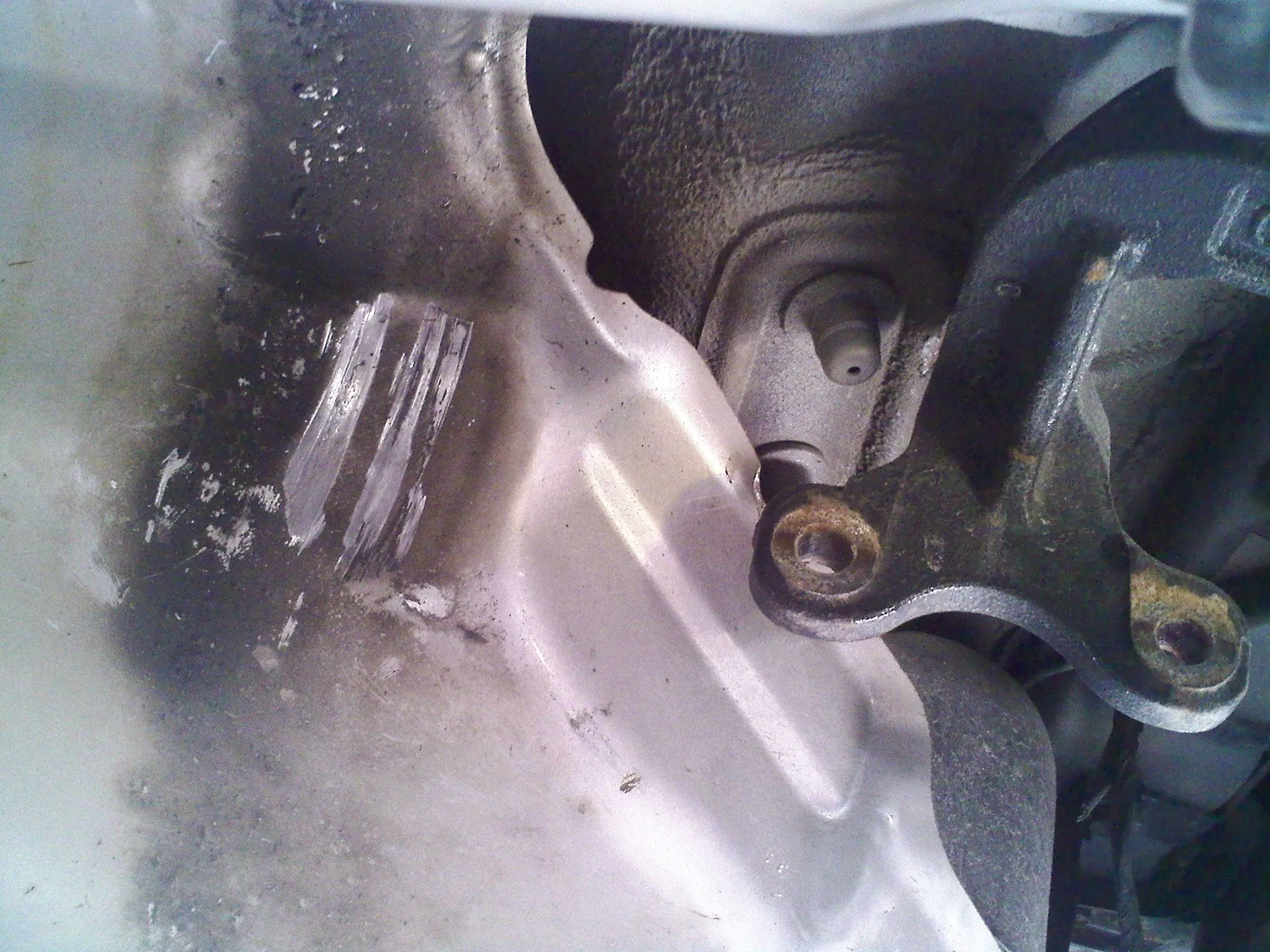

Lately I've started to notice a sort of ... maybe grinding noise coming from the rear under hard acceleration in 1st and 2nd. Not really a clunking, but could that be the diff?

The only issue I've had is breaking the bolts off the front mount, but went overboard with some Grade 8 bolts vs the stock grade 5. The grinding noise could be the driveline rubbing up against the heat shield for the gas tank. Not to mention if you're having a problem with that front mount you'll end up having CV axle issues. Plus the add stress on the stock rear mount.

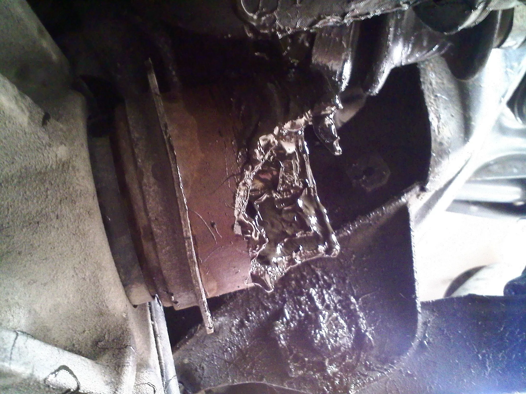

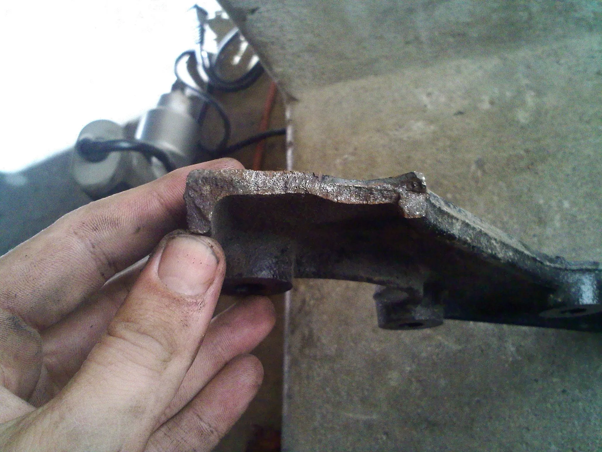

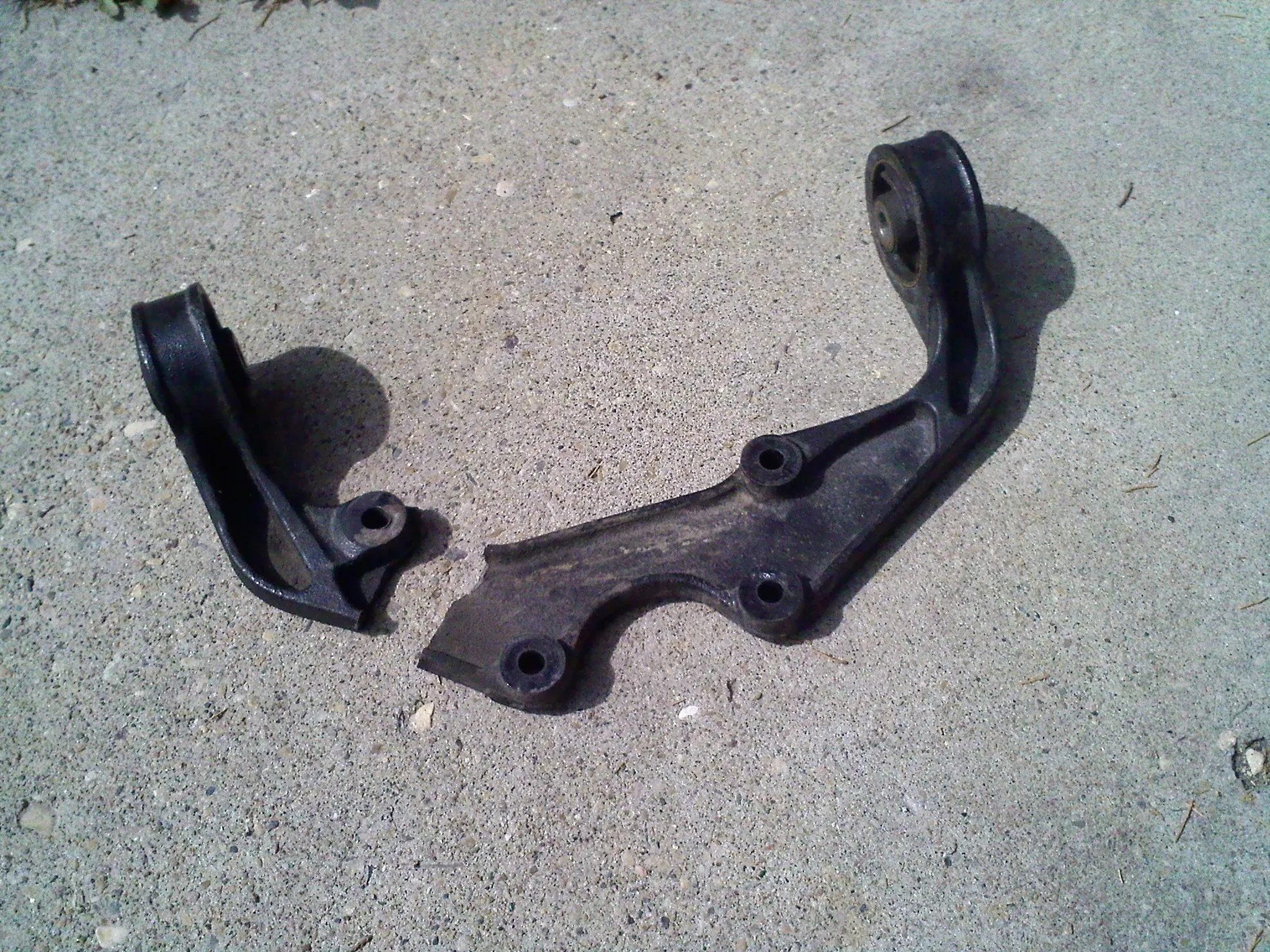

Thanks, I'll look into this. That first picture you posted is just horrifying. (nervous)
And thanks for the details Bova. I think I will try to go with the TT mount and see how she feels.

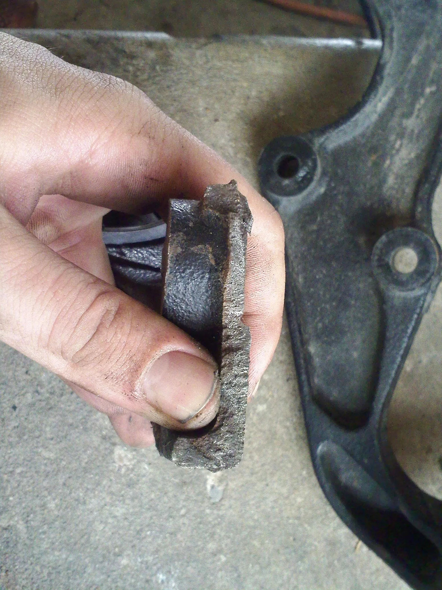

I got a pic what it looks like. This can happen with the rear or the front mount broken. Kind in mind that the you have a broken mount it will only compound damage done.
I'd take a look at the rear mount too. Mine started cracking. you can see where the rust started, and then the finally broke all the way through.
I was getting some minor thud noise. All I can say is if you can catch it all before it all goes to hell. the better.
