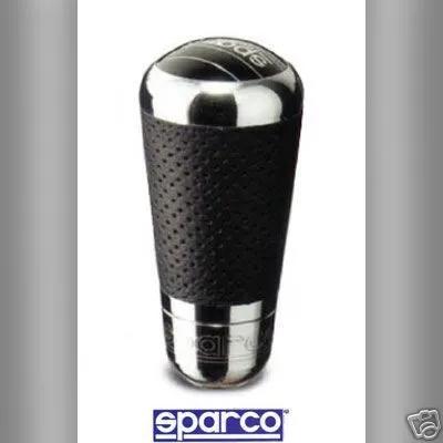

this is the only knob i found so far that kinda resebles ours, what do you think?
It's not bad but I kinda like the stock knob. I went to Autozone and looked at all the knob's they have there and I could not find one that I liked, though I will admit that's not saying much for their selection. I think the stock knob is heavy enough to work well with a short shifter.
i love the stock knob!, but if i cut my shifter, then i lose the the thread to screw my shifter back on, unless i solder the thread piece back on which would prob look like crap...
