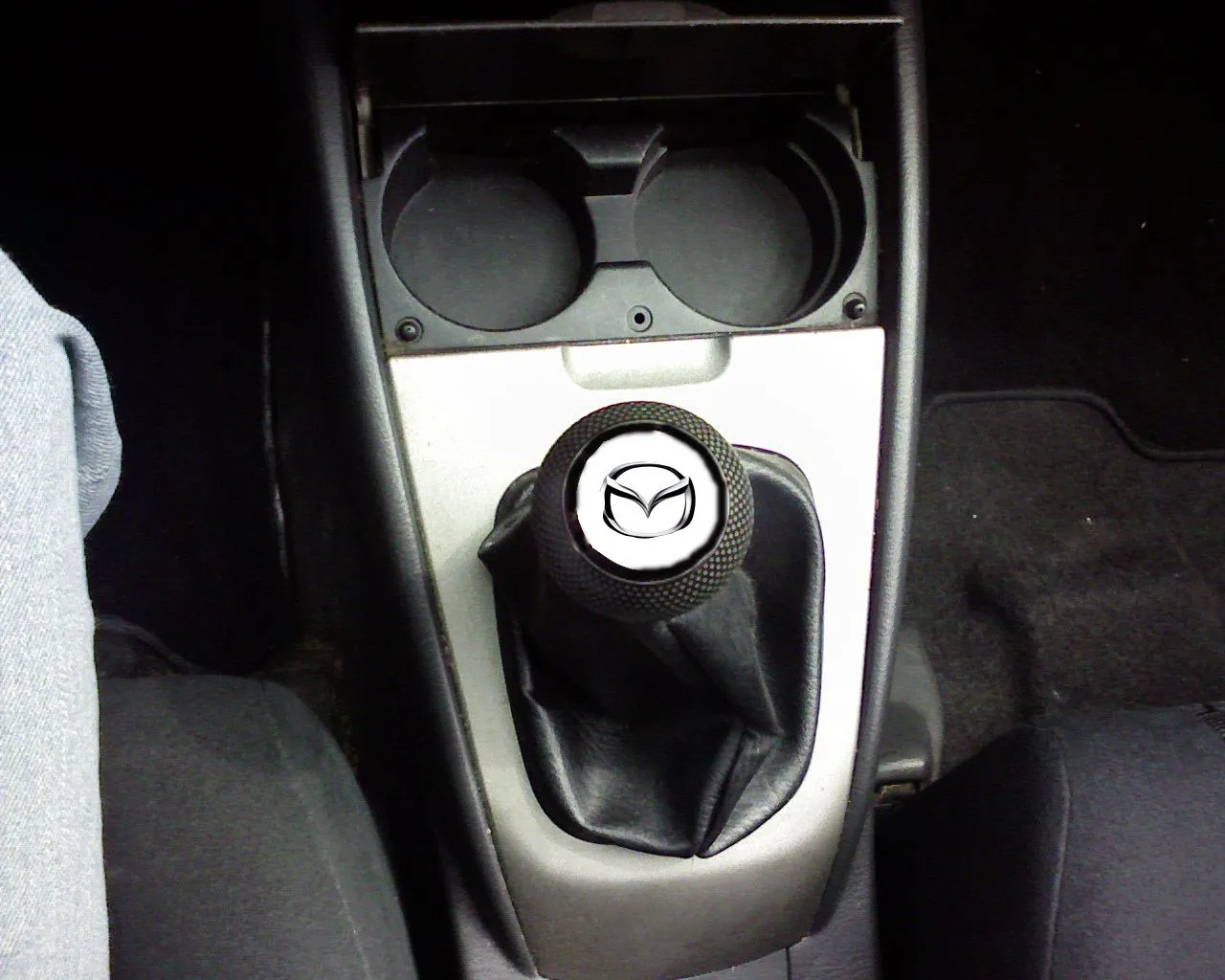

So the paint on my shift kob is partially peeled off and it looks pretty ugly. I have decided I want to paint the background white and paint a black Mazda logo in the middle.
Here is how it looks now:
my.php
And this is a quick photoshop of how I roughly want it to look:
my.php
What kind of paint do you think I will need for this? I'm guessing spray paint that's meant for automobiles....
Tell me what you think and how I should do this.

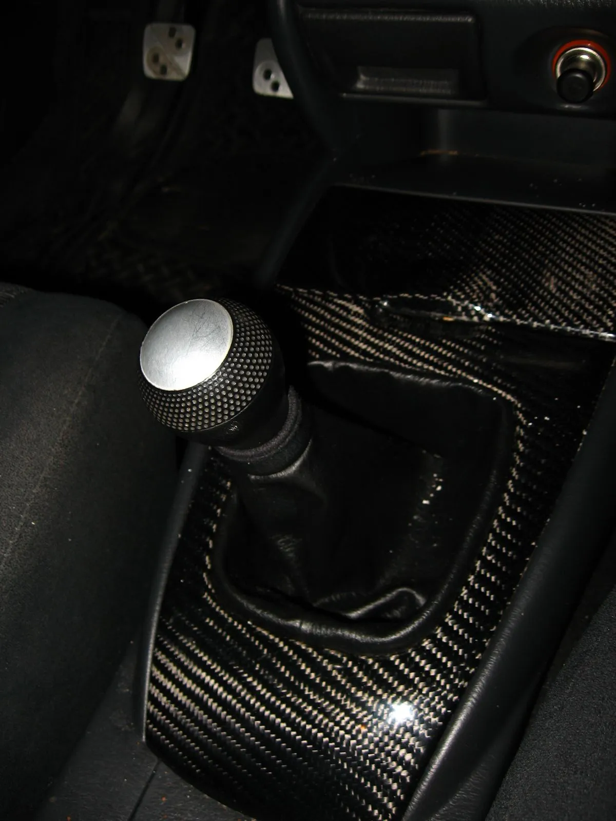

My knob had the same problem with chipping and looking like crap..I just pulled the cap out and sanded it...Which looks like this....

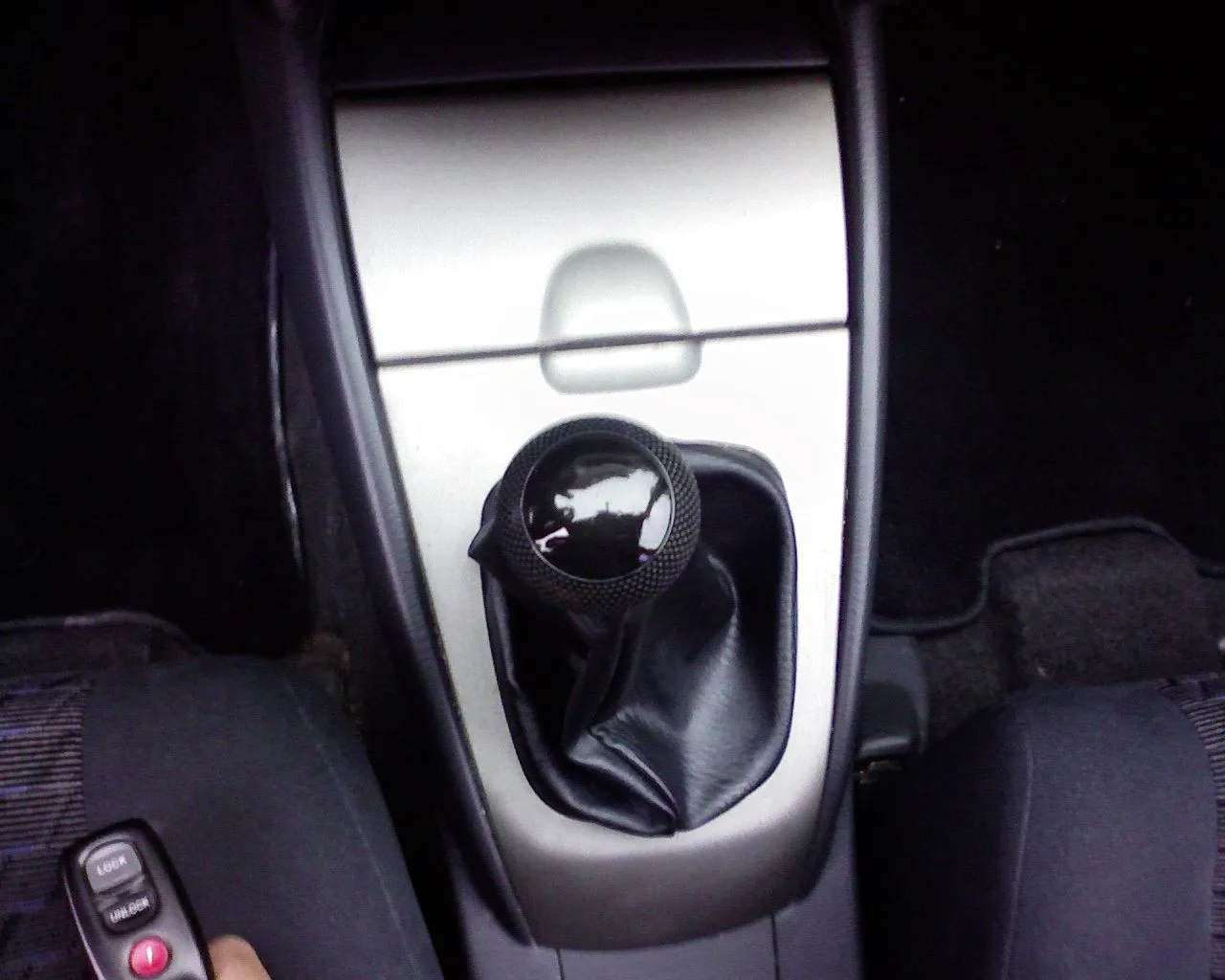

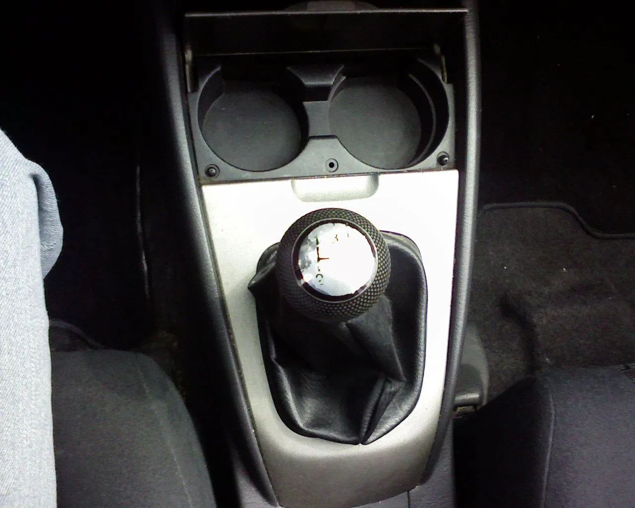

But besides that, last night I painted the top black. It looks really good as it is and I think instead of having a white background, I'm gonna go for the black background and white logo.
Here's a pic of the progress so far...
Matt

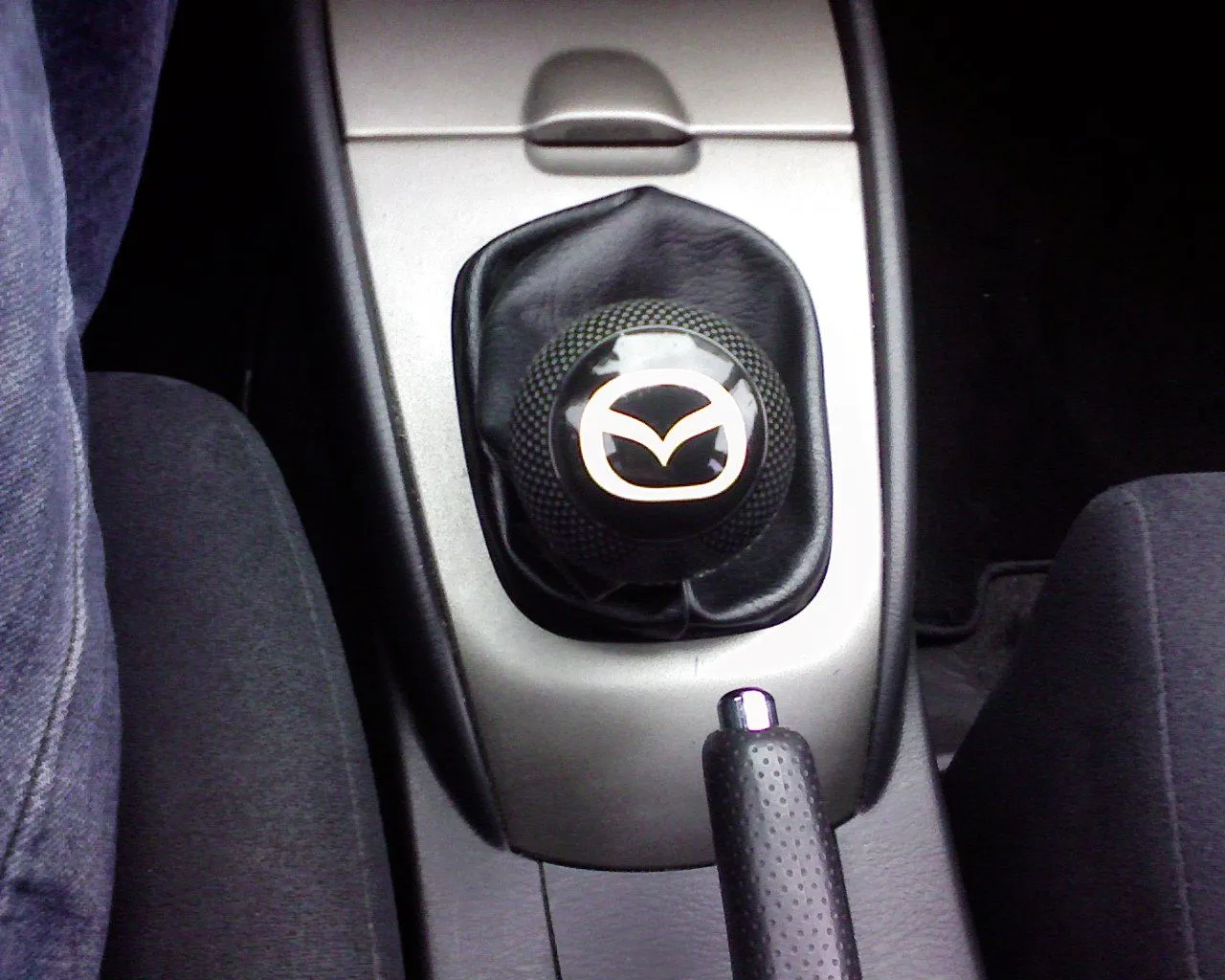

As for my shifter, here is the semi-final product attached...
Now all I have left to do it clear coat over the sticker and voila!
Matt
