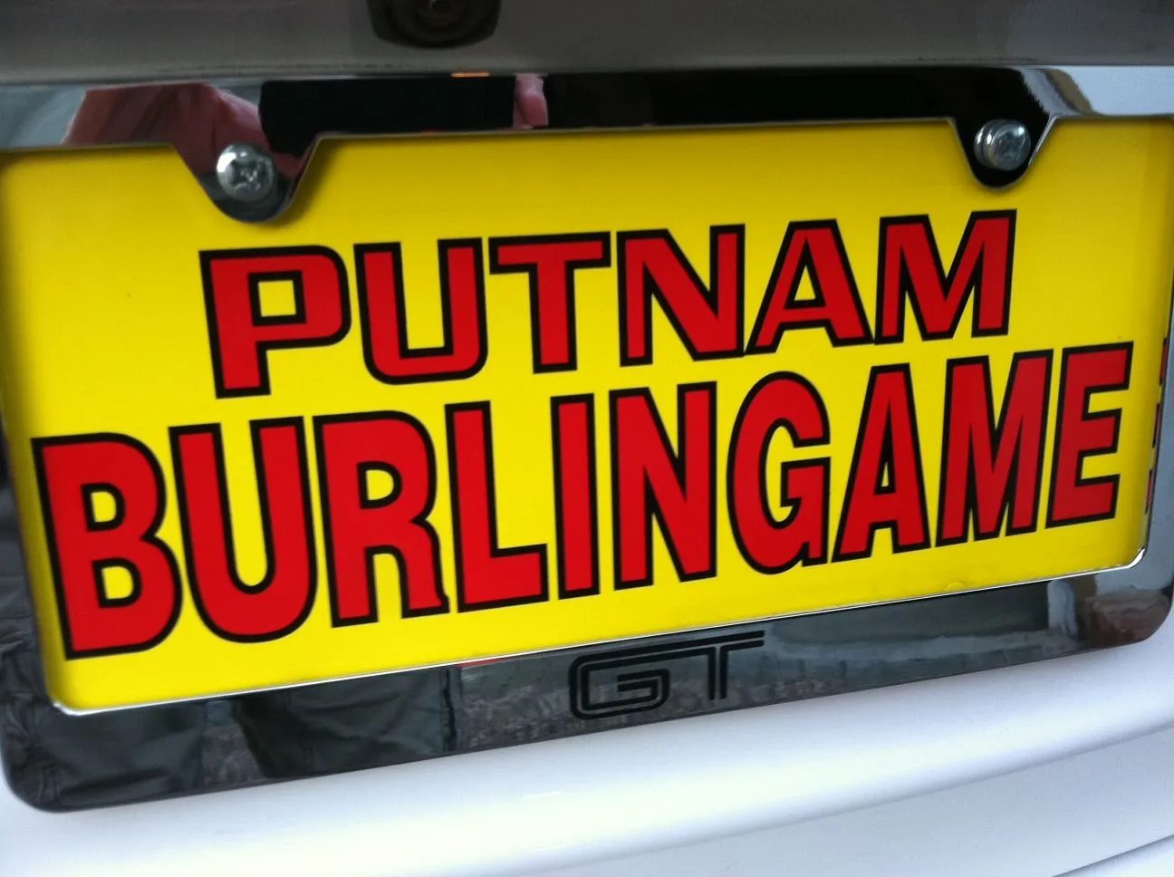

Wait, you have the Enterprise edition? :p
GT (gran turismo), check out my GT license plate frame, ricer-effect/good for extra top speed.
View attachment 200278View attachment 200278
I want a plate from Japan for the front ;) not sure how rice that would be...
